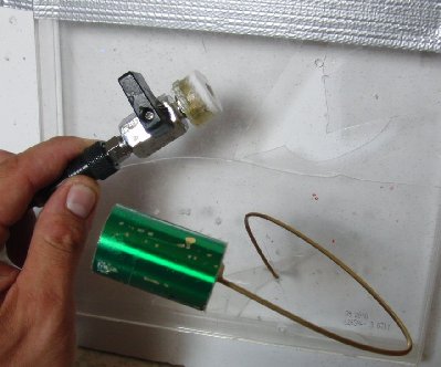

Wow, today really isn't my day. After blowing up a hybrid, I went to console myself by testing the new version of the 1mm BBMG. I loaded about 4000 rounds and decided to see how long it would take to empty the chamber in a single burst...
Clucking bell!
I think I'm going to hang up the bent barrel as a reminder, MAKE SURE THE EPOXY IS FULLY CURED!!!
The barrel embedded a good 1/8" into the wooden board, with the other end of the plug still connected to the paintball tank

I hate to be that dude who is saying the same thing over and over again... but don't you think that metal fittings might have some advantages ? :wink:
Get a bunch of fittings and you'll see what I am talking about
No need to wait 48 hrs - join a few fittings together and that's it
The arguments for fittings certainly seem strong, but there's nothing wrong with high strength adhesives - one only has to use them properly :roll:

The barrel and chamber looks like some kind of abstract sculpture... sell it to a gallery and it could fund your epoxy supply for decades to come!
Which is why we've never seen even one all metal gun that failed yet roughly 30-50% of your prototypes explode violently ? :D
POLAND_SPUD wrote:roughly 30-50% of your prototypes explode violently
Oh come on, it's nowhere near that number :P and in every case it's happened so far, it's either due to insufficient curing time or severe underestimation on the part of yours truly of the forces that will be generated.
