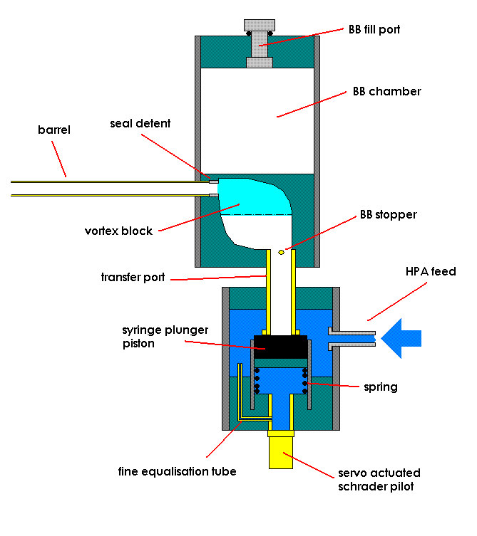

Well, technically then this isn't double posting :D Here's vaguely what I had in mind for the "gun" portion of this project, basically what I was trying to do here (but using an airtight piston made from a syringe plunger so I can have a separate equalisation hole of predicatable flow) coupled to a vortex block BB chamber.
rp181
Posts: 1090
why not a solenoid valve?
It would be difficult to get a servo to push a schrader reliably. If your looking for lower flow, there are valves like these:
http://www.legoeducation.us/store/detai ... =0&t=0&l=0
Its used for lego pneumatics, that would be easier to actuate.
I have a couple, they work great.
If you put a little silicone grease in it and work them, the become very easy to move.
stuff from lego pneumatics operates at a couple of bars max... he wants to use hpa...
but I agree that a solenoid valve could be used here

rp181 wrote:why not a solenoid valve?
I imagine it's hard to find one rated for the pressures I plan on using
... but would they take 800 psi? I think I will look into lego pneumatics anyway, they seem to offer quite a few interesting options for lower pressure projects...
I don't see why it would be difficult for a 6kg/cm servo to open a shrader, if it doesn't manage to open it directly you could always have the schrader operating a double action spring loaded trigger, though this would not allow full auto fire.
