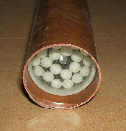

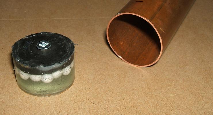

Here's the latest piston I cast for a 3/4" high pressure pneumatic I'm making, inside the copper pipe I'm using as a chamber.
I got a bit creative with the filling, I popped a few airsoft BBs in. It didn't do much for the the weight as they sank in the epoxy so are more dense, maybe 0.12 grams next time ;)
smoothed down and ready to be sealed inside
freshly popped out of the mould, needs some finishing

inonickname wrote:Though I'll admit I was worried for a second that you were considering using PVC in it..good to see you're using something which can take it.
After a certain amount of prototypes blow up one you, one does tend to become a bit careful :P The barrel is PVC but it's 3.5mm wall thickness so no worries there.
Will it be serviceable?
The piston won't be removable, but the pilot will be a 1/2" ball valve and I'll cast it around the thread so that will come off with some effort without destroying it.

Of course ideally it would be servicable, but such is my manner of construction. I do though make my pistons in such a way that (provided they are made well in the first place) they don't really need maintenance, no lube is required and the only seal is the sealing face which is 1/4" thick so it is unlikely to wear out for the duration of the launcher's usefull life.
