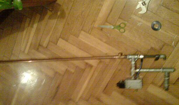

ok here it's... forgive me their low quality but I don't have much time take pics.. right now it's 95% completed and it works... I still have to tinker with o-rings (they are either too loose or they leak) and solder one joint
I've just realized it's damn hard not to have your feet in the pic when you take a photo of something lying on the floor... oh well all foot fetishists have to wait till I finish it

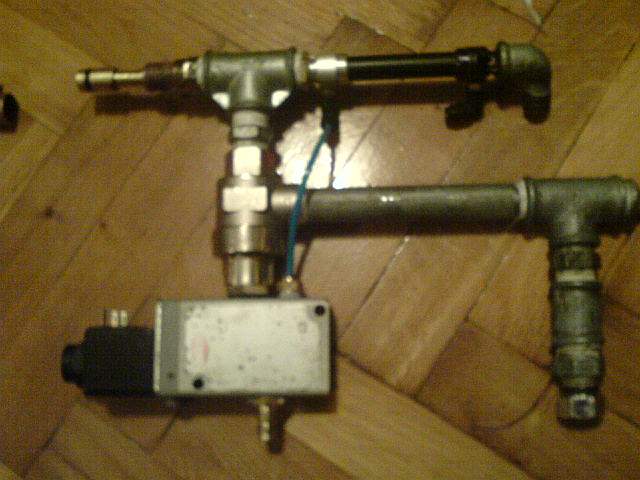

that big rectangular thing is a 5/2 valve (5 way / 2 position).... in one position it sends air to the air cylinder while venting the QEV... in the other it vents the air cylinder (I added a spring) while filling the QEV
at the bottom there is the quick connect male thing as well as two ports for venting (not visible)
that brass thing is the bolt - it's normally in forward positon (in the pic) when I activate the valve QEV fires and air is sent to the air cylinder, which retracts the bolt... a marble falls down and as I depress the button it's sent forward into the barrel and the bolt closes off ammo port (copper T)
