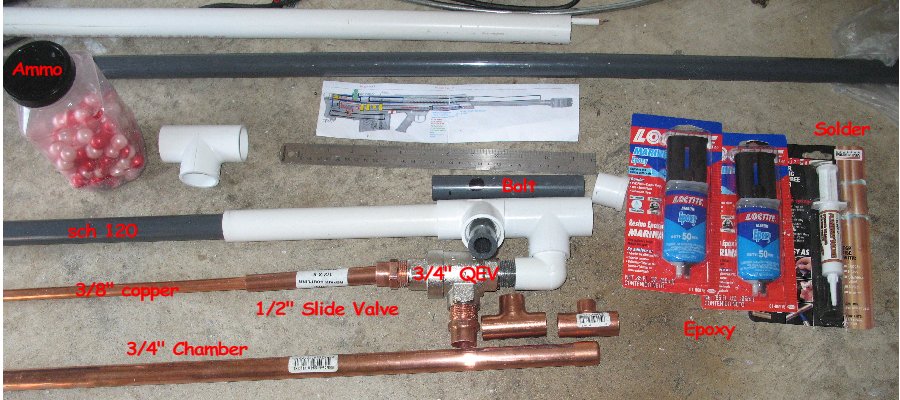

Well, I've got together most of the materials, and have begun assembly.
So far, I turned the barrel down to sleeve into 1" sch 40 pvc, modded the ammo feed tee, cut some pipe and dry fitted stuff together.
The paintballs have an excellent fit into the 3/4" sch 120 pvc. Using the barrel like a blowgun, the paint broke easily from 10 yards away. GGDT says I need about 50 psi to achieve 300 fps with the 3' barrel and 1' chamber.
I have yet to machine the bolt to fit, and I still need to get o-rings and other small parts. I am worried about fitting a spring, o-ring, and blocker wire inside of the bolt, and also about it's small surface area. It has an area of .4917" squared, so 50 psi will result in about 25 pounds of force on the bolt.
Also, will the air from the 3/8" slide valve (with 1/2" sleeve) be enough to fill the 12" by 3/4" chamber 8 times a second at 50 psi?
