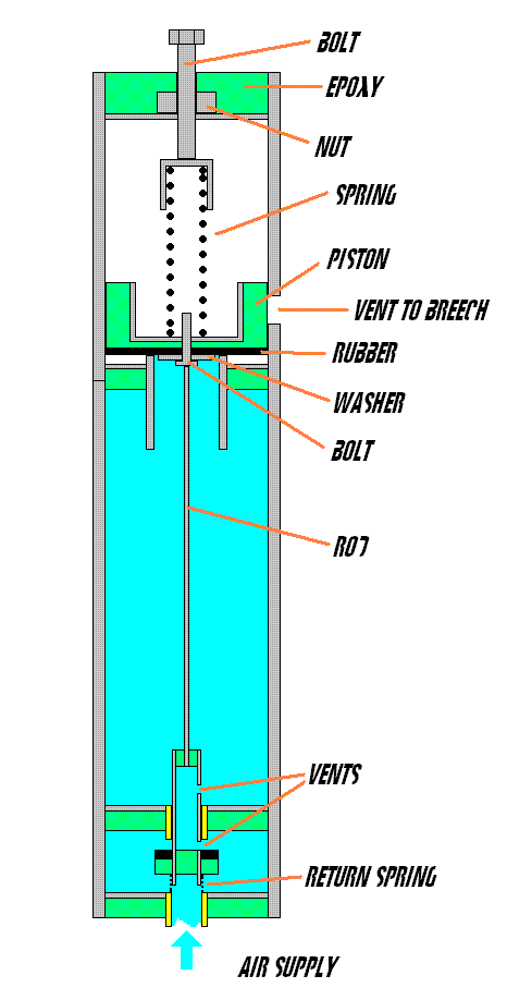

looks like it would workthough the rod looks a tad unsopported and would need to be well rounded off to avoid damaging the flap.

Yeah, both good points. I still haven't figured out a good way to make that valve. There ought to be a way to build one into some brass fittings on the way from the blowgun; that would eliminate a few building steps.
Instead of that rubber flap you could simply fit a schrader valve

Hahah, a schrader, why didn't I think of that . . .

(Edit: is there any way to increase the flow through a schrader? I'm a little worried about the flow rate: it'll be fine for a small-bore, but a marble gun with that kind of flow wouldn't cycle too fast. You know, I'm fairly certain Hawkeye has some experience making check valves inside brass parts. I think that might be the best way to go.)

I always thought this design would be better, but I had to give the pop-off pilot a go first. I'm currently making what should end up looking like the below diagram, at the moment I'm casying my largest ever epoxy piston, a massive 1.3 inches in diameterI'm glad you have finally seen the light

I see, the piston makes contact with the rod as it closes. Why the complicated air control valve, though? Wouldn't a simple check-valve style be better? I imagine you have a reason for making it that way, I'm curious what that is.

It lets me use 6mm o/d aluminium tube for the vented portion riding in 6mm i/d brass that will keep the rod supported and nice and centred, besides it's not *that* complex reallyWhy the complicated air control valve

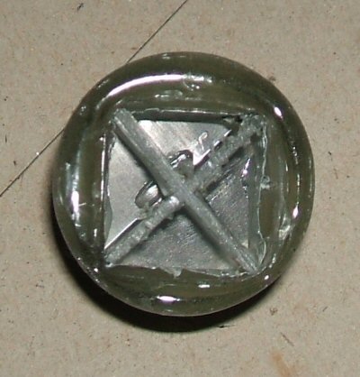

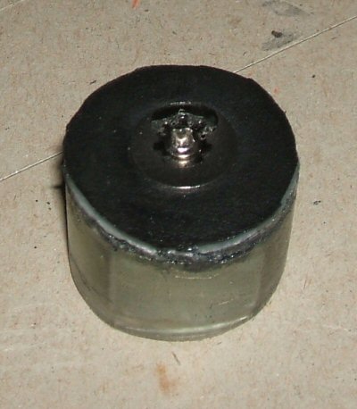

Here's the enormous piston
by adding an internal structure (basically a cruxiform syringe plunger wrapped in duct tape) to the casting it's not only light but also saves on epoxy, while still being strong enough for the job. This is how it looks like fresh popped from the mould, still needs some finishing.

But that'll cut your firepower. The air will go faster through that opening than through the barrel, and then it will slow down in the larger area in front of the piston, and then have to speed up again down the barrel. That's going to cost some energy.
Also, if you are looking at 1.3" piston then your firing pressure will be 6x higher than the closing pressure, so if it's 110 psi, you'll have 17psi left in your firing chamber after the shot. Not much, from an efficiency standpoint. I was thinking about using a sealing area about 1/4 the piston area (so half the diameter).
Surely you can come up with a 37lb spring if you can get 22 lbs! At the least, all you have to do is run the tensioner bolt in.
The issue is that that's quite a bit of stress, which the launcher will be constantly under, unlike normal pistons where the stress is only there when the launcher is pressurised. Besides, given the way air is transferred through the holes in the cartridge, there will still be a choke point for the flow.

hmm, I can see that it would be under stress, but why's that a problem? and anyway, you could just pull the spring out when you are going to shoot it. But I can see it being a difficulty to assemble the thing with the spring putting that much force on the setup.
