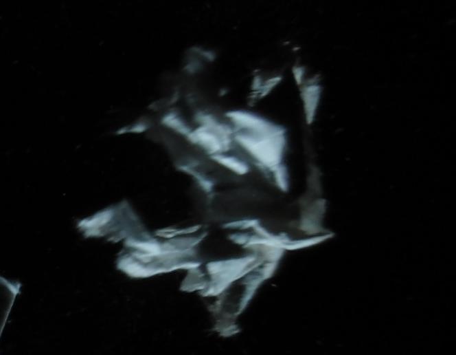

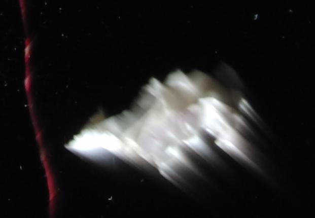

Interesting, my disposable camera triggers worked even when shorted through 200ft of AWG 16 extension cord (working on a hybrid), so resistance shouldn't be the issue. You could try putting triacs in parallel, and maybe gating them with a simple transistor.
And BTW, you should consider making the whole setup modular, and getting a Vivitar 283 off eBay. The cut off feature helps greatly with the afterglow and reduces the amount of light. These crops were taken with a setup similar to that of your clothespin (same thing, more duct tape)
- withoutcutoff.JPG (12.55 KiB) Viewed 2733 times
- withcutoff.JPG (30.61 KiB) Viewed 2733 times
