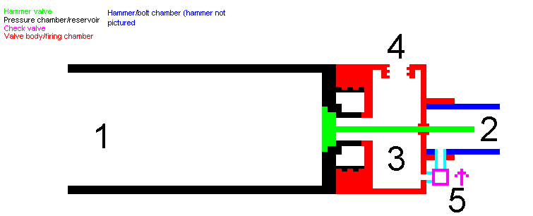

Jack; this is what I pmed you about.
Better?
Hammer (2) strikes the valve stem, allowing air from reservoir (1) into the firing chamber (3). Some air ports to barrel (4) and fires projectile. Air also ports through a check valve (5) to the hammer (2). This pushes back against a spring until it reaches an exhaust port. After reaching this port the bolt snaps forward, striking the valve and repeating the process.

Essentially isn't it just a slightly reconfigured variation of this?

Not really. This ports immediately to the barrel, allowing for full power. Air is then diverted to a check valve which operates a separate blowback mechanism.
Without the check valve air would flow all out of the barrel and not actuate the blowback mechanism.
So basically:
You lose power
OR
You lose full auto
This keeps full auto and full power by not using exhaust from the blowback to power the gun. That said, it's less efficient again as you're running a 2 cycle engine that's doing near nothing except strike a valve.
You could use the exhaust air for something to do with a hopper like someone suggested.
inonickname wrote:Not really. This ports immediately to the barrel, allowing for full power. Air is then diverted to a check valve which operates a separate blowback mechanism.
In my design above the blowback operation is ensured by making the air push the hammer back before being able to exit to the barrel.
Air will simultaneously go both into the barrel and blowback mechanism, and once the projectile has left the barrel all the air will go through there as it is the path of least resistance. In this case the check valve is a good idea, because the air then won't have the option of exiting the barrel.

Yeh.
The reason this design would be more powerful than yours is because it expands several times before even hitting the barrel (so your basically just using an exhaust), mine uses a charge that goes straight to the barrel and one to the hammer. Less efficiency, moar power.
