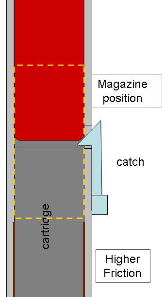

to prevent jams you'll just need to prevent cartridges from moving forward due to friction from the retaining bar, so you can make some sort of catch mechanism or adjust it so the areas in contact with the cartridge (besides the retaining bar) will have higher friction
also are you suggesting that safety be integrated into the score or what should I do
- top view
the retaining bar is not displayed - ensuring shell reliability.PNG (10.13 KiB) Viewed 6070 times

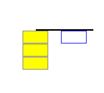

@iknowmy3tables: What do you mean retaining bar? That was something I mentioned for my original idea in a recent thread but I've since scrapped that idea and now I'm going with something like this:
(Credit for that picture goes to POLAND_SPUD)
In this design, the force of the magazine spring is used to push out spent shells.
What I'm concerned about is that the shell that needs to be ejected will not be pushed straight up and instead will be pushed up at an angle causing it to get stuck in the ejection opening.
And in regards to safety, let me rephrase what I said because I was unclear. I personally don't think that the presence of safety features should be part of the scoring process, I just think they should be a requirement for all entries.
- And of course a crappy animation.
- RSPmag1.gif (11.17 KiB) Viewed 6022 times

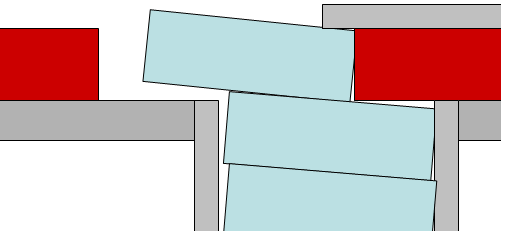

also I guess I misinterpreted the design you were going with, in that case my concern would be something like this happening
- jam.PNG (7.44 KiB) Viewed 6017 times
