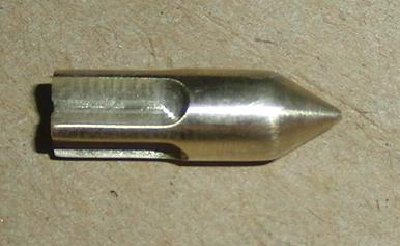

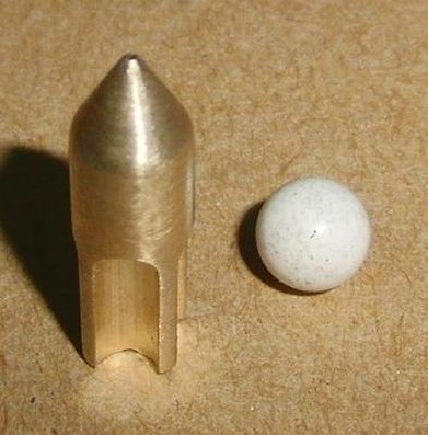

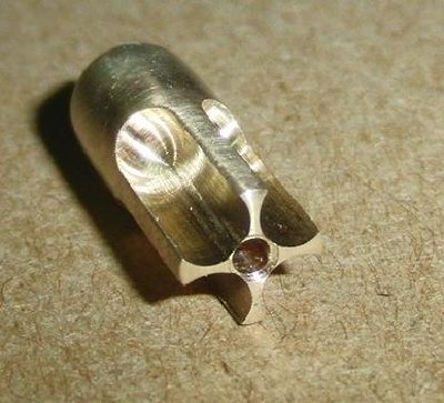

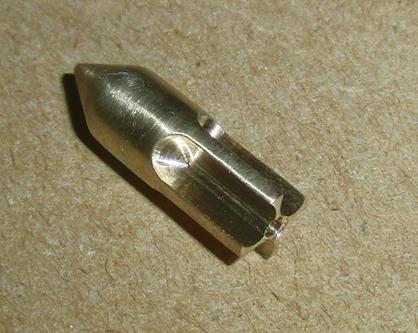

Ah but I love machining ;) here's something I made in the meantime just for the sake of using the mill that was feeling a bit ronry, haven't worked up the courage to fire it yet.
compared to a 6mm BB for scale

Dang that'd be amazing if it flies straight. Lots of wasted brass though :( Should have used crimped Al fins, and epoxied it all together.
Like seriously, I'm going to be trying making some projectiles with that crimping method, it's genius.
These projectiles may be stable but probably have reasonably high drag too, not necessarily any good for long range
Depends what you understand by reasonably high drag :)
If they are close to G8 shape that's already a huge step forward... ohh and don't forget this projectile can have very high sectional density
Personally I like the one that consists of just the cone and the tube - damn simple
I don't think we need another miniboy that's too valuable to lose - ammo has to be cheap

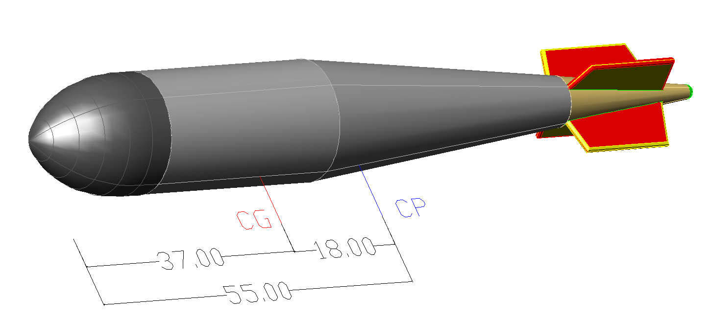

Speaking of the MiniBoy, I'll have to tune in to this thread later once I can sort out the CG, I believe dewey-1 already calculated the CP:
dewey-1's picture
dewey-1's picture
