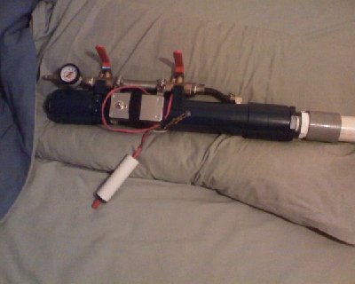

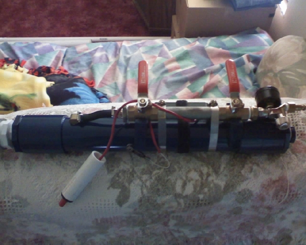

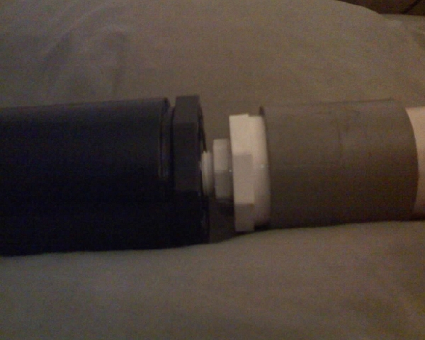

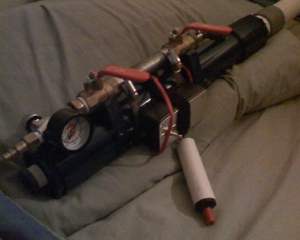

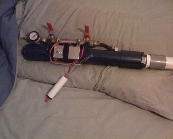

I have a combustion which uses metered propane, BBQ sparker ignition with a single spark gap, and a 50mm chamber fan. The gun's chamber is made of a 17.5" long section of 2" SHC40. It uses a 2"x¾" reducer bushing with a ¾" end cap, and a 2"x½" reducer bushing for the barrel union. I have a ¾" barrel for shooting batteries and stuff, and a 1½" barrel for golf balls, persimmon's, spuds, etc. The 1½" barrel is 35" long and the ¾" barrel is 48" long.
I know the ¾" barrel is way short for a good C:B ratio, but the 1½" barrel is right on for a 0.8:1 ratio. My question is why does this thing shoot like a pea shooter? It looks impressive as hell but when I fire it, it's like... that's it? I fired a golf ball tightly wrapped in paper towel today, and when it fired it couldn't have traveled more then 100ft (guess-timating).
My question is would a 2" chamber reducing down to ½", and then back up to 1½" have any effect on power? Is my fuel mixture off? If you would like to see what I mean I can put up a video on youtube.

I belive that your ristrictive setup is the main problom.
You should always have the reducer specific to each barrel so that you can have the optimum "valve" size.
I think that if you cut off the reducers and reduce your gun down to only 1.5 inch for the golf ball your performance will be much better. Im not sure on the fuel mixture-maybe a video?

frankrede wrote:Great googlay mooglay!
Thats a beast!
I've rebuilt this gun once already because of a broken solder connection on the chamber fan. If I cut off the bushing again it will make the chamber even shorter and the meter will hang off the back, which it already does by about an inch.
If you guys are positive the crappy performance is coming from the reducer setup, I'm gonna tear it down and use the meter and fan control box on a 4" chambered cannon. It's a shame too cause this thing looks hella cool.

I see no other reason for the lack of power other than the flow restriction.
Remeber, when you cut the diameter of the pipe in half, you reduce the flow by a factor of 4.
That pipe appears to be the color of sch80 pvc, did you paint it?
If it is just normal sch 40, it wouldn't cost all that much just to get a new piece of pipe and a couple fittings rather than cutting the current one down more.

Yes, go with a long, 4in diameter chamber. And put the reducers on the barrels. Anytime you restrict it below the diameter of the barrel, performance WILL suffer GREATLY!

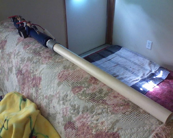

Ok the 1/2" reducer is definitely the problem. I put a valve on the barrel union and left it closed, then attached a 1"x3/4" adapter to the rear of the gun with a 1" barrel exactly 8ft long. I dry fired it in the house and saw a flash travel down the barrel and heard a loud pop. My brother was outside and heard it also.
The only problem is that the chamber fan is in the very rear of the gun which is now the front of the gun. Will the pressure damage the fan? I have it super glued to the chamber wall and it's a very tight fit so I don't think it will come loose.
