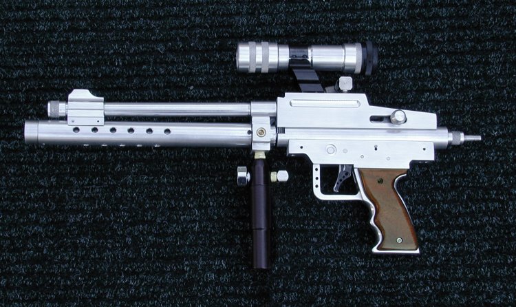

Full auto prototype

Care to share the details of the breech mechanism and mag feed?

Thanks as always for the comments Jack. At some point I will take the gun apart and photo everything. As for putting anyone to shame, I,m just trying to share what I have with everyone. It,s not ego, just what I do.

I'm really curious about how it feeds and fires, is it some sort of blowback/forward mechanism?
It really works like a full auto airsoft gun. It is blowback. The piston has a spring that pushes it back and hits the air valve and goes forward again. The trigger was a bit complicated but works. The same system could be used for spud guns. I have not gone there yet.
Okie, more questions: Is the magazine a gravity-fed hopper like on paintball guns or spring-loaded like airsoft? What sort of pressures are you running at and any clue what sort of velocities you're getting?
It would work with a compressed air gun. I would like to try propane but have not yet figured out the continuous fire system. I have a prototype system that works that way but requires a continuous spark. When the chamber reaches the right ratio it just fires automatically.
The mag is spring loaded in the tube on top. I don,t like the looks of hoppers. It can also be suction fed but that.s another system.
I,m not sure about the velocities. However I did fire at a full can of soda from 30 feet and the plastic bb went right through.
It uses regulated co2. I think it is set at 150 lbs through the regulator. I bought it from Palmers Pursuit shop.

awesome gun sounds like it works just like a typical paint ball gun like the spyder
