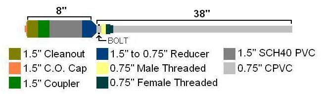

Before anyone says anything, I know, don't shoot people with a homemade paintball gun, the ammo commoness is why I want to make one.
Im attaching a small, simple drawing describing my idea for the gun. Its a plain vanilla gun, nothing fancy, the usual RightGuard and grill peizo ignitor. The reason I'm posting is because I want to get it right before I waste money on the wrong things. I decided to use the male/female threaded fittings for later expansion (several barrels). Im also choosing CPVC for the barrel because from what I've read that is a perfect size for paintballs. Also, I calculated out the volume ratio with RatCalc and its ~0.81:1 (C:B). Well, I can't really elaborate much more... any suggestions or flaws?

I wouldn't step down your chamber from 1.5" to .75" since 1.5" is small enough. I would step up your barrel from .75" to 1.5" That way, you are able to take advantage of your male/female adapters by adding barrels up to 1.5" without the restriction of reduced flow. You don't want your barrel to be larger than your chamber because that creates a bottleneck at the male/female adapters and greatly reduces performance. Your design is fine... I would just change the reducer coupling to be on the barrel rather than the chamber.
So instead of the 1.5" to .75" reducer on the chamber, put a 1.5" female adapter and then on the barrel, put a 1.5" male adapter to 1.5" pipe to 1.5" to .75" reducer to .75" pipe. That will allow barrel sizes up to 1.5" with increased performance.
taterjim
Posts: 123
Joined: Sat Jul 23, 2005 10:14 am
A 1.5" barrel on a 1.5" chamber would not work well .with that small of a chamber 3/4 " is about the largest barrel I would use. I wouldn't change a thing.

Alright, thanks guys.
