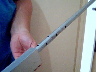

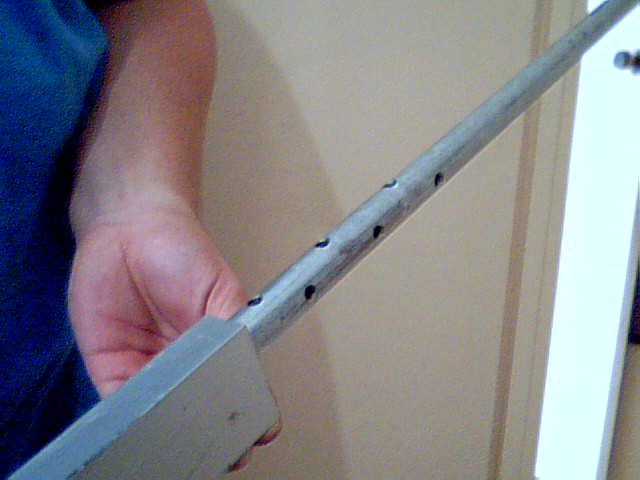

This is my best mates new rifle. He wanted one ever since I showed him my airsoft pisser-offer-er. He had a rough idea of what he wanted so I came up with a few different plans. This was the one he chose. Yes I know people are gonna be saying that the chamber is way too big, that looks weird or what not....but it's a top gun, is comfy to hold and great to shoot.

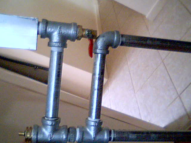

It's a 6mm bore with the chamber being the built in stock. It's accuated by a 6mm ball valve that serves as a trigger. The piston design was of which I use in my airsoft guns. It works perfecty with no real problems, and if there is one.....its nice and cheap to fix not to meantion easy. It's opperating pressure won't be that high because of the chamber size and the fact that a mounted pump instead of a shock pump, will be alot harder to use when the pressure hits the 150's.
Any questions on the gun, feel free to give me a bell.
Stats:
Total Length: 1340mm
weight: 3-3.5kg
barrel length: 915mm
chamber volume: 222ml

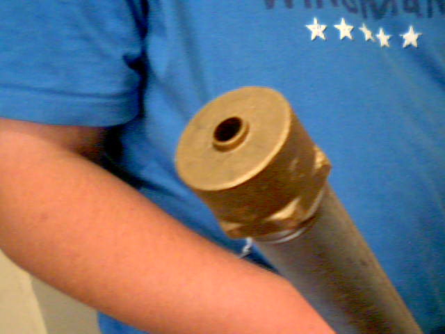

Ammo: Anything that will fit in the barrel haha. Primarily 20mm slugs machined from 6mm steel rod.
Additional: Supression chamber that covers the barrel. It may appear that the gun is coax but it's really well.....yeah....a suppressor.
Anti Elephant Airsoft Rifle

is tht a wooden stock spraypainted or just a hunk of metal?

i mean the retangular part. what is that?
Then why does it have holes in it?! - other than that, great piece of workSupression chamber that covers the barrel. It may appear that the gun is coax but it's really well.....yeah....a suppressor.
duct tape over the holes and he should notice the difference - I assume there are holes in the barrel tho?
I may be stupid and blind, but how in the holy hell did you make a square with threaded elbows? Isnt that supposed to be kind of......not possible. OMG NOTHING IS REAL!
