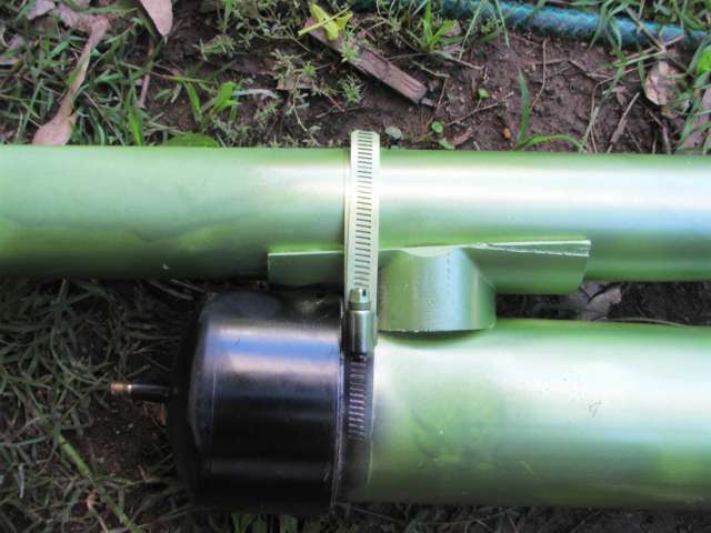

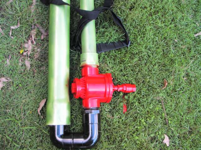

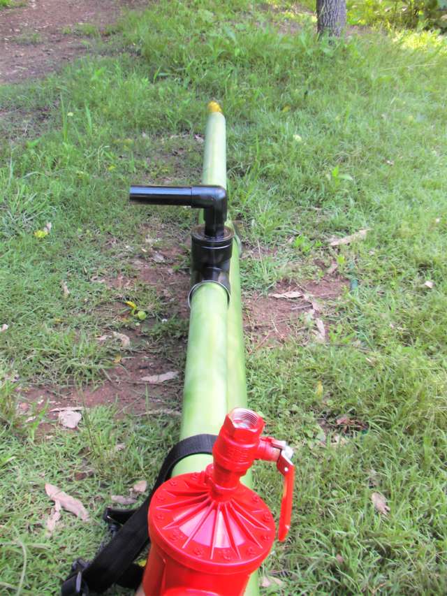

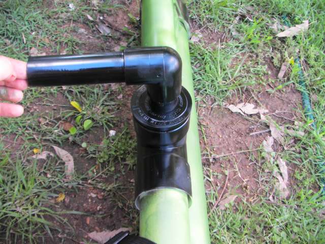

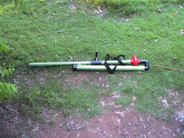

This is my new cannon Ares(god of war). It was built after I was inspired by woffers and pcv's 2" sprinkler cannons.
Chamber- 4.5ft of 3" pvc

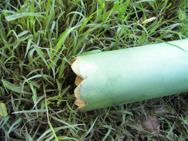

Barrel- 6ft of 2" with a potato cutter tip
valve- moddified 2" sprinkler valve acctuated with 3/4" ball valve
psi range- 60 to 116psi( ear plugs are a must!)

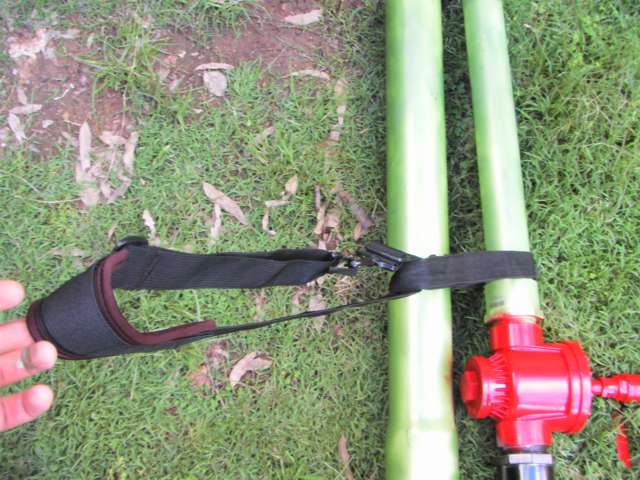

other features- handle and shoulder strap and soon laser sighting.
primary ammo- potatos and lemons, soon I will fill an old spray can with water and freeze it :twisted: we'll see how that goes.
Thanks to pvc arsenal 17 and rna duelers for their help.
here are some pics, soon I'll have a dmg video I still need to edit it.
edit: this pic of it whole is misleading, the barrel is not at a steep angle as it looks in the pic. I had to take it from my balcony to get it all in, the cannon is lying on its side so it looks more angulated than it really is.

Nice and big, shame you couldn't extend that brace a little. This looks like it can deal out quite a bit of punishment, damage pics!

The support system is kinda awkward but nice gun.

the support is fine so far, tight and strong.
It is a mutha to shoot though and take pics of at the same time. I tried to to a barrel cam thing but failed miserably :( I'll get some pics by mid week and hopefully a video too.
Im keen to use the 150grm frozen spray can :twisted: I just need an adequate target to destroy.

Awesome cannon, mtronic! I've been waiting for this. Post videos!
How'd you get the valve working?

Like the sling and the handle concept, not quite so impressed with the muzzle knife - looks a little sloppy and not very sharp either.
Imagine it's powerful though because of the large valve, bore and long barrel.
