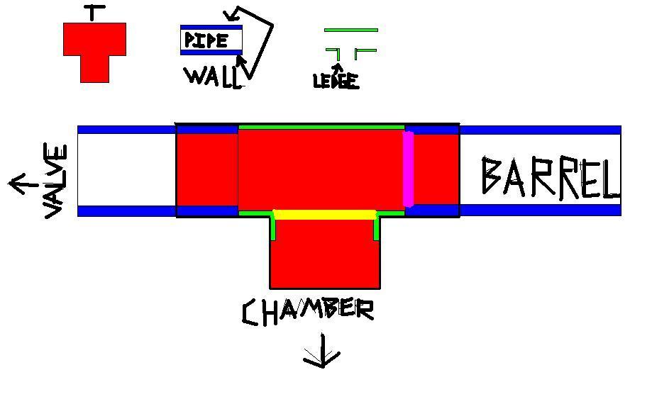

ok i looked around but i still need help. i get how pistons work but not what size to make them cause i don't know where they seal. do pistons seal at the yellow line or the purple line?[/img] sry i'm such a noob and don't quite get it so plz don't yell at me.

the face of the piston seals against the edge of the barrel (purple line) while the o-rings seal off the chamber along the sides of the T (green lines to either side of the yellow line).
Ntw, paint does have a text feature, you don't have to scribble out the labels ;)
yeah what JSR said, though the seat (barrel/purple line) has to be a smaller diameter then the face of the piston.
This is so that there is air pressure pushing the piston back, and when the air pressure behind the piston is gone (i.e you empty the pilot volume with your pilot valve) the pressure pushes the piston back and opens the barrel up to air flow.
You don't need o-rings btw, they just increase performance.

so do i make the piston so it can slide in the pipe to the pilot and a bit thiker on the other sid so it blocks the barrel or the size of the ledge(green)? and yes i totaly forgot paint had a text option sry :oops:

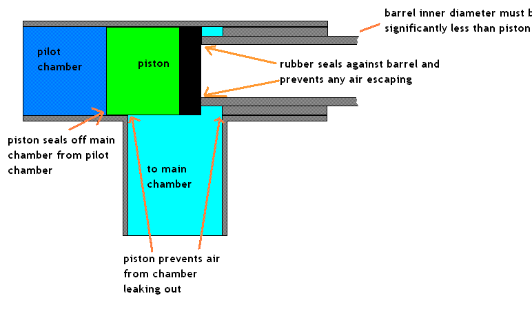

let me c if i can dig up one of my old paint photos.
This is a very bad photo but bear with me. Ok for the size of the piston, in your diagram it should fit the diameter of the blue line. The sealing face has to be smaller than the barrel. You want to make the piston tight. You want to make the piston long enough so that it reaches the barrel and doesnt fall off the pipe that its fitted to.

I'm in a godawful patient mood for a Sunday morning, here:
edit: modified diagram slightly to address MrCrowley's concerns ;)
If you're lucky i'll spend a few hours making a new animation tomorrow, my old one is a bit worn out, but in the mean time JSR's excellent diagram will do. :wink:

ok ty guys. i'm in no rush i haven't even tested my first gun. ya the diagrams are great but how much larger do i need the piston to be? a 1/2 tee won't work for a 1/2 barrel? and i know i have now where near enough knowledge to start a piston gun i was just gathering info. thx alot guys :D
You could get it to work but it'd be a hassle and have poor performance. It'd be much easier to go 3/4" or even better 1".
