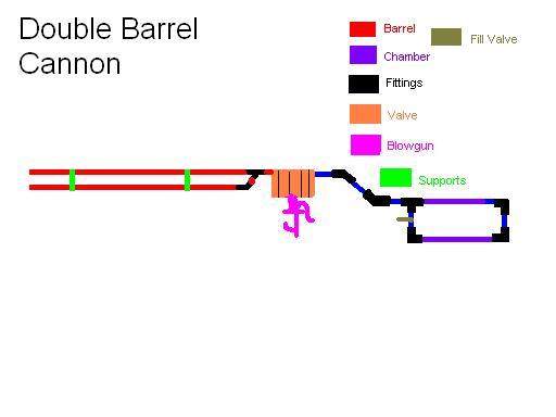

heres my new double barrel design. tell me what you think
- double barrel cannon.JPG (15.07 KiB) Viewed 10447 times

Its nice but with in your design, the connection of the lower barrel, cause the lengths to be different and the lower barrel to be longer overall.
I think you need to focus on making the barrels same length overall...
But beside it i think the design is good.
i'll make a drawing to explain in a while.

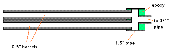

If your barrels are say 0.5", hooking them up to a 3/4" valve like in the attached diagram, you'd get no loss in performance save for a little extra dead space.
Go on, let's see more creativity and less off the shelf parts on this forum
- doublebarrel.GIF (3.4 KiB) Viewed 10417 times

i just made a drawing of how i think you should make a double barrel...
yeah it;s pretty simple but it's my idea of launching 2 projectiles same time same force different barrel tell me what you think..
i get it that the drawing look a bit like an ass,
but i dont care(dot)(dot)(dot)
[edit]: sorry for double post problem max_users_connections or whatever...

idk if im lookin at the diagram right but is that just epoxy acting as the wall? i just like the reliability of parts off the shelf. or maybe get a joint that actually looks like a " Y " and make it side by side double barrel. im not 100% if im right but should the airflow divide evenly both ways if its side by side? im just tryin to milk everyone of their superior knowledge ( something i dont have haha).
If you get a "Y" fitting that's the same diameter as the barrels, you'll get half the flow going to each barrel and less power. With my design and using a 3/4" or even better a 1" sprinkler valve, you'd get much better performance.
I'm a big fan of using epoxy as a casting material for custom reducers and endcaps, have a look here and at any of my finished projects.
