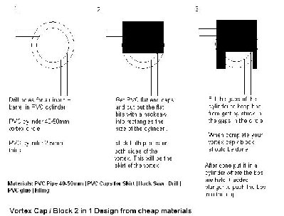

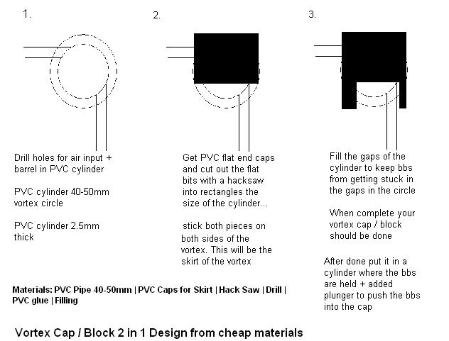

This was a design and idea i've thought up since i didn't have materials to make a vortex block ... and the Vortex Cap on spudwiki seems cumbersome because of the sticking out magazine though i have no idea how Davidvaini (sorry if i spelt ur user wrong) made his vortex cap inline with his P90.
Yeah well this is an alternative for noobs like me on making a vortex cap with limited materals... tho Davidvaini idea's good too but i want to make mine inline....
Hey Davidvaini if you have any idea how i can make your vortex inline could you please tell me? cause i was goign to go on the lines of your weapon...

That idea is good, but I'm not sure you would even need the skirts on the vortex block. I have tried to make a vortex block that way before and it didn't turn out too good because I found it pretty hard to drill in the right place on a round pipe without the drill bit trying to slide off the side of the pipe.

haha! thats what i was thinking but i thought of like putting a piece of support triangular support wood like so i can drill a hole into that into the pvc pipe... obviously u'd probably have to glue the wood on ... i reckon it's easier then doing a vortex block... and i have no idea how davidvaini made his vortex cap inline XS
