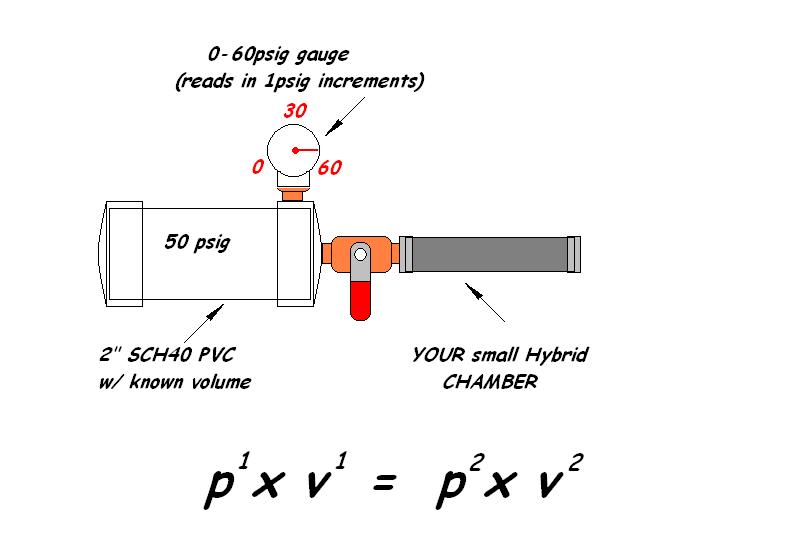

What would be the best way to get the most accurate reading for a small chamber volume.. are the only 2 ways to measuere chamber volume water and sand or something similar? This is crucial beacause my chamber is very small and I need a precise number so I can get the mixes right...

10 ml Syringe, fill with water. Fill chamber from syringe, not how much is missing. Or use a larger syringe if it's bigger.

The only problem is my "main" chamber is a cross made of forged steel... I believe that if I measure the volume with water it might cause oxidation of the cross...I could paint it or something but that would just be too much trouble imo. Is there any way I could go around this without using water yet still getting an accurate result? :roll:
Tue Mar 09, 2010 5:13 pm
hmm... what about other liquids, like for example oil?

theBOOM wrote:The only problem is my "main" chamber is a cross made of forged steel... I believe that if I measure the volume with water it might cause oxidation of the cross...I could paint it or something but that would just be too much trouble imo. Is there any way I could go around this without using water yet still getting an accurate result? :roll:
no water.JPG (30.06 KiB) Viewed 73319 times
theBOOM
Posts: 374
Location: San Antonio, TX
Tue Mar 09, 2010 9:14 pm
Thanks Dr that should be easy to work out :P
