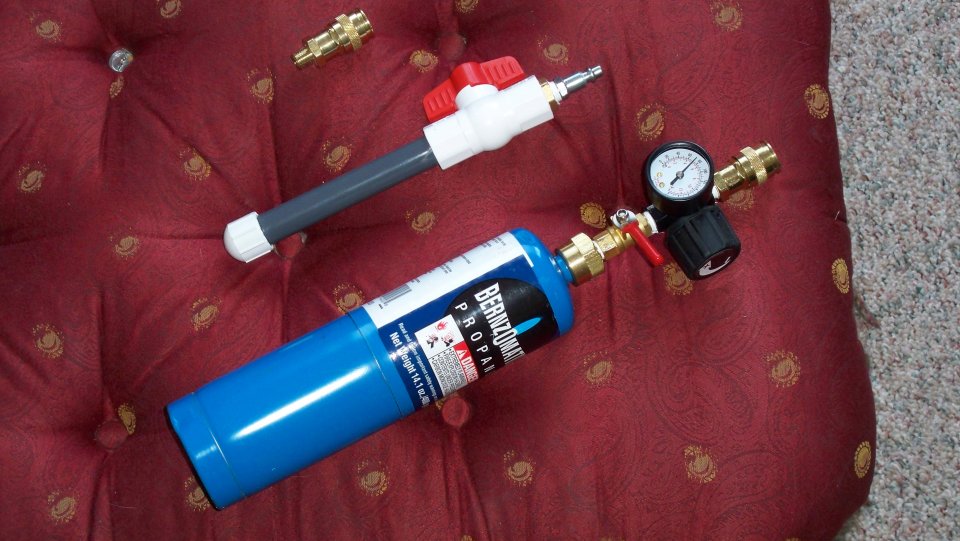

This below is not a complicated metering system. I'm using these for some noise making cannons. Just attach the quick connect to the chamber in a double walled area. Calculate the size and PSI of your meter tube and you are done. This one works in a 3660 cc chamber when filled at around 63 PSI propane.
Edit: This will also keep the weight of your cannon down by not including the propane tank and metering system as a built-in part of the gun.
You seemed determined to use any and every kind of fuel other than the one that has been deemed generally by time and consensus (propane) to be the best bang for the buck. Why is that? Anyone that is too young to walk into a Home Depot and buy a tank of propane should probably have their parents overseeing things anyway.
If you don't want any of these things you're down to a basic spray and pray PVC model, easily slapped together in a few minutes time. Do you really want to waste your time documenting such an already plenty documented beast?

And starman, this is for the noobs. When I first saw a propane metering system, I was scarred away by it's seeming complexity. I'm sure other new users would feel the same way.
Take another look at the meter....very simple. Noobs need to be building a spray and pray like I mentioned before....not much need for all this documentation you're attempting. www.burntlatke.com is the defacto standard for combustions and answers many of the issues you put forth.
