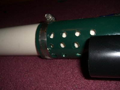

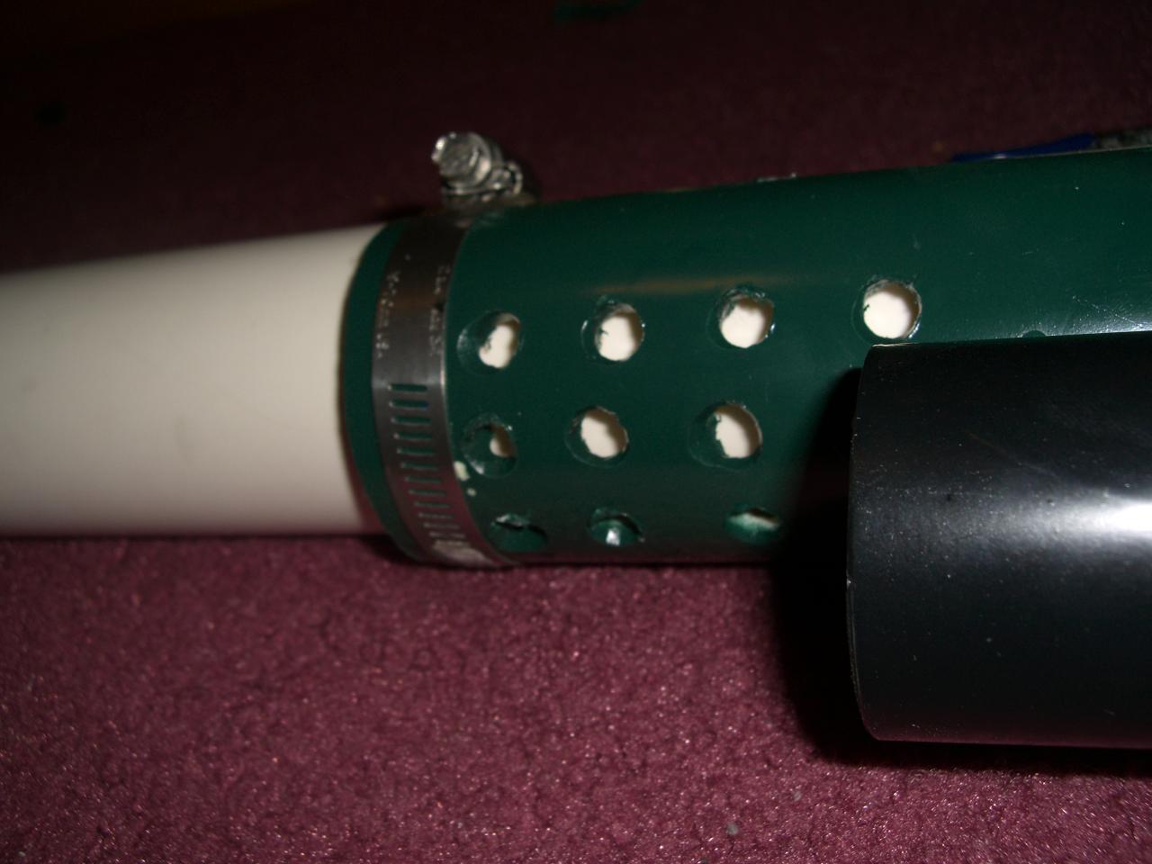

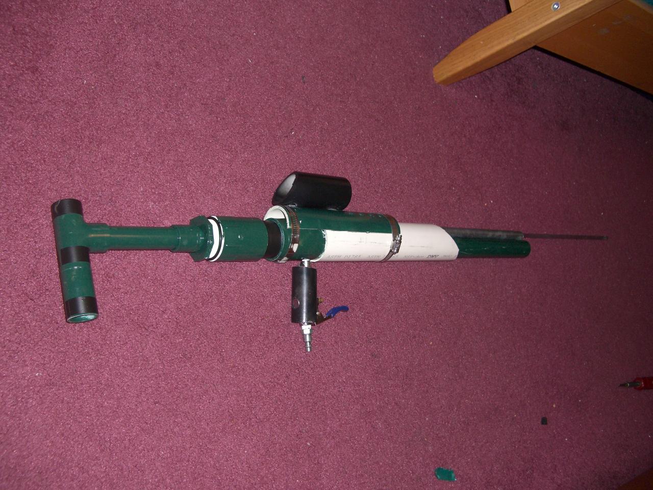

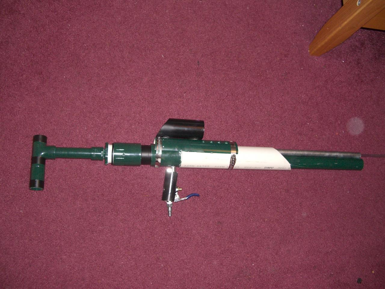

After the gator l1 i decided to make a new more better looking one, so here its is tight bore acrylic barrel chamber 1.5, new barrel shroud aluminum barrel housing, and ghost ring sight, it now fires 60-70rps ranging from 350-410 fps at 120 psi using my 10 gallon air compressor.

Looks great. You really did a great job with the materials it's constructed from. I am usualy more interested in a bullpup configuration for that type gun so that surprised me.
Looks very ergonomical with the shoulder stock and sight set-up. I take it your shoulder stock is removable too?

To load i just unscrew the stock, thats why theres an o-ring to prevent leaks since Teflon tape wears out alot when you threaded and unthread constanly.
Yes a shoots 12g bbs and thanks
Im working on another one that looks the the ultimate inline and or I might incorporate one into an air soft rifle.
