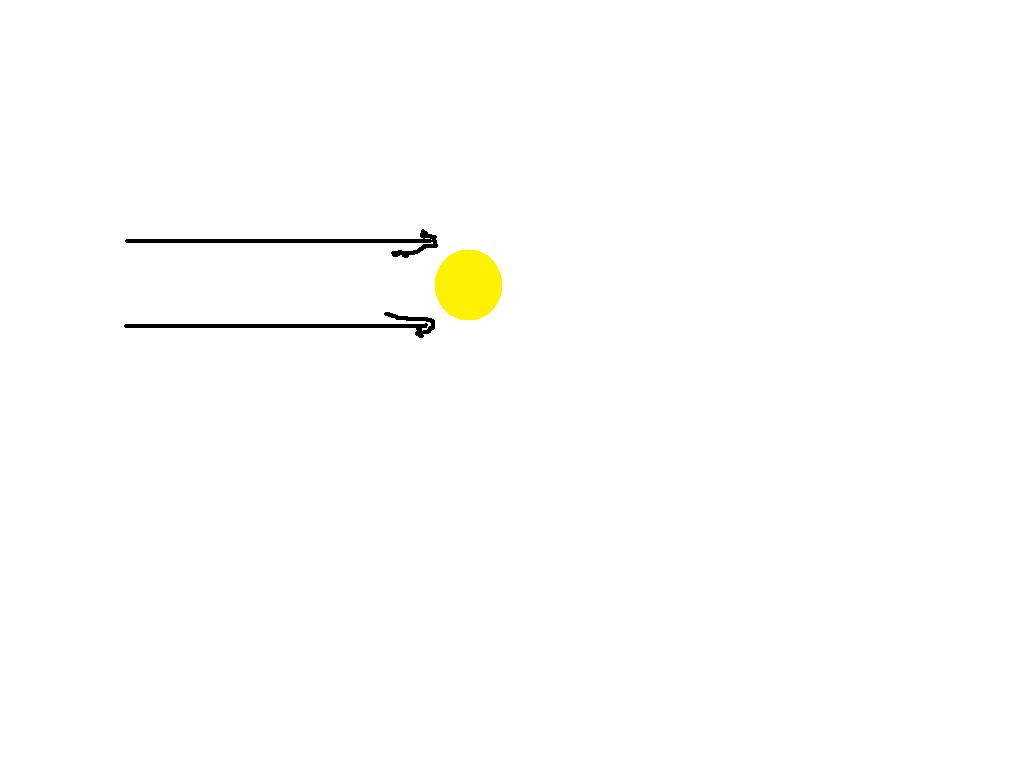

the old baloon breech..
cut the neck of a baloon and put the baloon part in the breech and take the thick end of the baloon on the out side of the breech it is hard to explain with no drawing..

spudfarm wrote:the old baloon breech..
that is a really good idea
nice and simple and yet im guessing effective.
Ill try it on one of my lung powered(yes I dont have a compressor)BBMG's today and see if it works.
Or even better, pressurise the BB chamber and use the Ball valve as a triggerbigbob12345 wrote:a good way would be to put a ball valve infront of the barrel(that the BB's fit through)and just open it when you are about to fire.
Thanks spudfarm, I really like your idea - seems easy and effective.
Though the ball valve suggestion's perfectly valid i think i'm leaning towards the balloon method for simplicity. I should be able to start building my bbmg this weekend, hopefully i'll be posting it pretty soon too.
