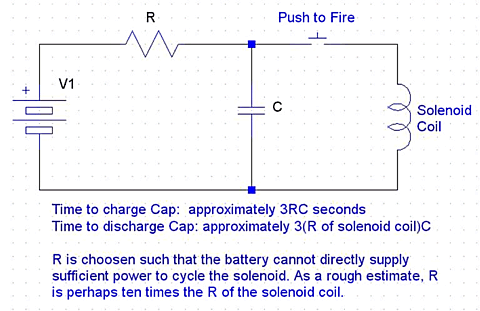

Here is a BBMG made from the water supply valve from a washing machine.
The capacitor really isn't needed, a switch and a battery work fine.
If you want to use a cap so the valve will cycle open then closed you'll need circuitry to control the charging of the cap. Not terribly difficult for low ROFs, gets complicated at high ROFs.
I would think it would take a pretty big-ass cap to supply enough power for long enough to cycle the valve correctly. A typical photocap (~120MFD) probably won't work but might be worth a try at voltages starting at whatever the solenoid is rated for and going up from there. (You can run the solenoid at higher than rated voltage for short periods of time.)
In the circuit below if the Solenoid coil is 10 Ohms and you want the valve to stay open for 0.1 second then the RC of the circuit needs to be ~0.03 seconds and the capacitor needs to be about 0.03sec/10Ohm = 3000MFD. That's a very big capacitor. Boosting the voltage will allow you to use a smaller cap but it'll be harder to come up with a suitable power supply.
Simple RC circuit to cycle a solenoid
