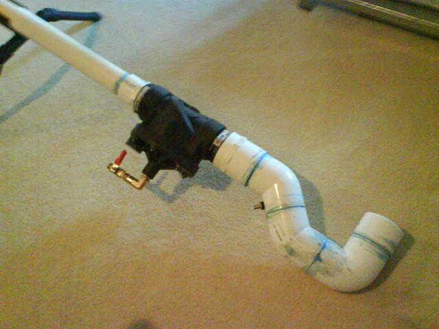

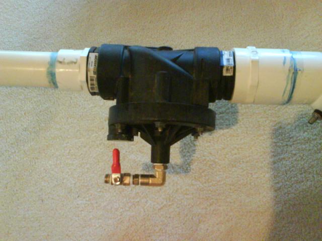

Jacksa26
Posts: 17
Joined: Thu Feb 21, 2008 4:38 am
Location: australia
thanks a bunch for all your replies guys, i ended up just using the 1/4in ball valve for the trigger. I added in a 1/4in elbow as well to make the design more comfortable/easier to use and i rekon it looks a bit better (see the pics below).
I tried modding a blowgun i had lying around but it still didnt make a difference when i tried out on the gun.
thanks again!
