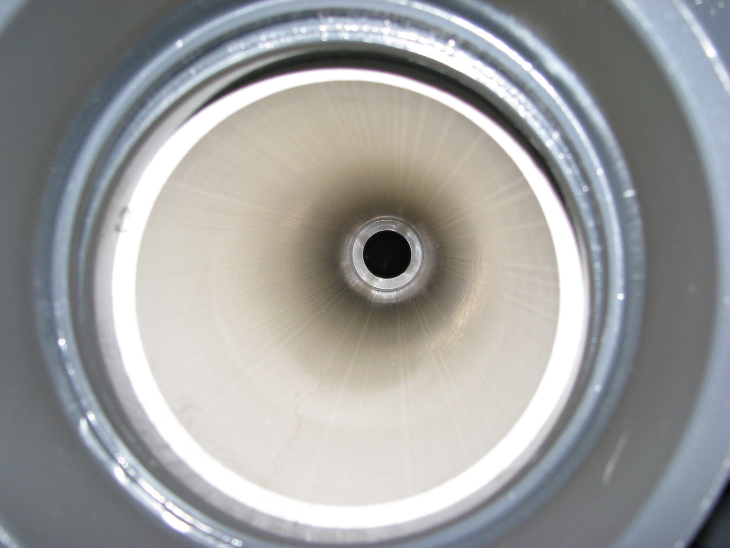

Down the chamber, from the flange.

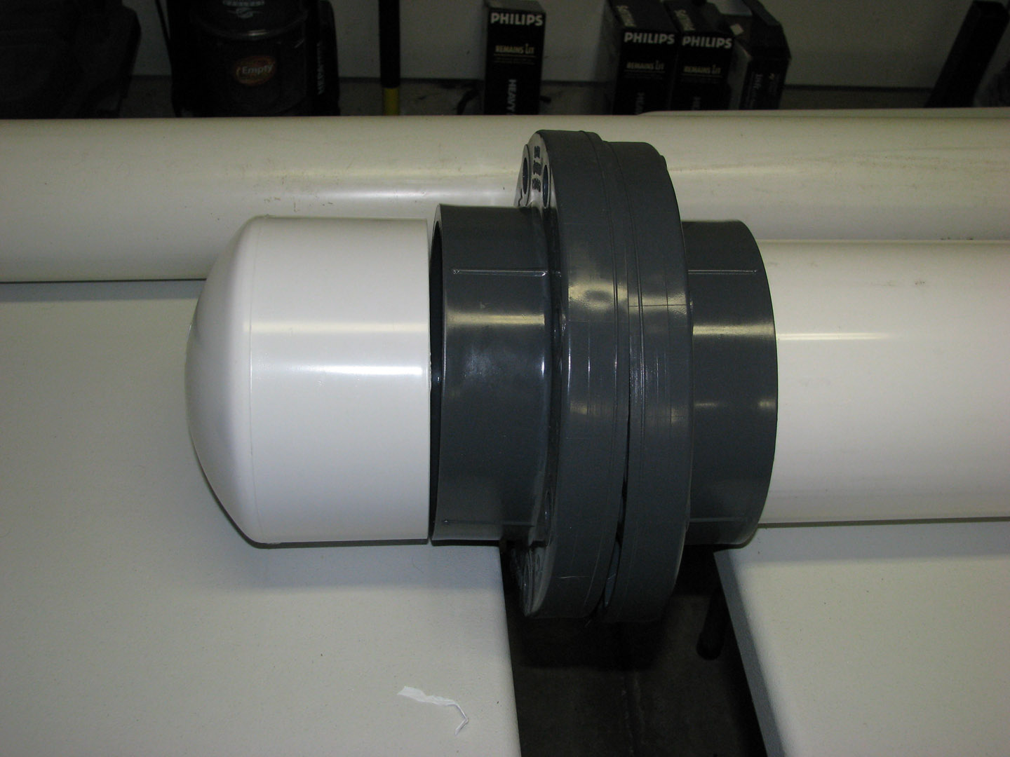

The end of the chamber.  So far, using flanges is the most economical method I've found to plug up the end of the chamber.  Since it's 6" ID, I plan on making a nice sliding spark strip that can be easily serviced without jamming my arm down the chamber.  I have lots of room, might as well take advantage of it!

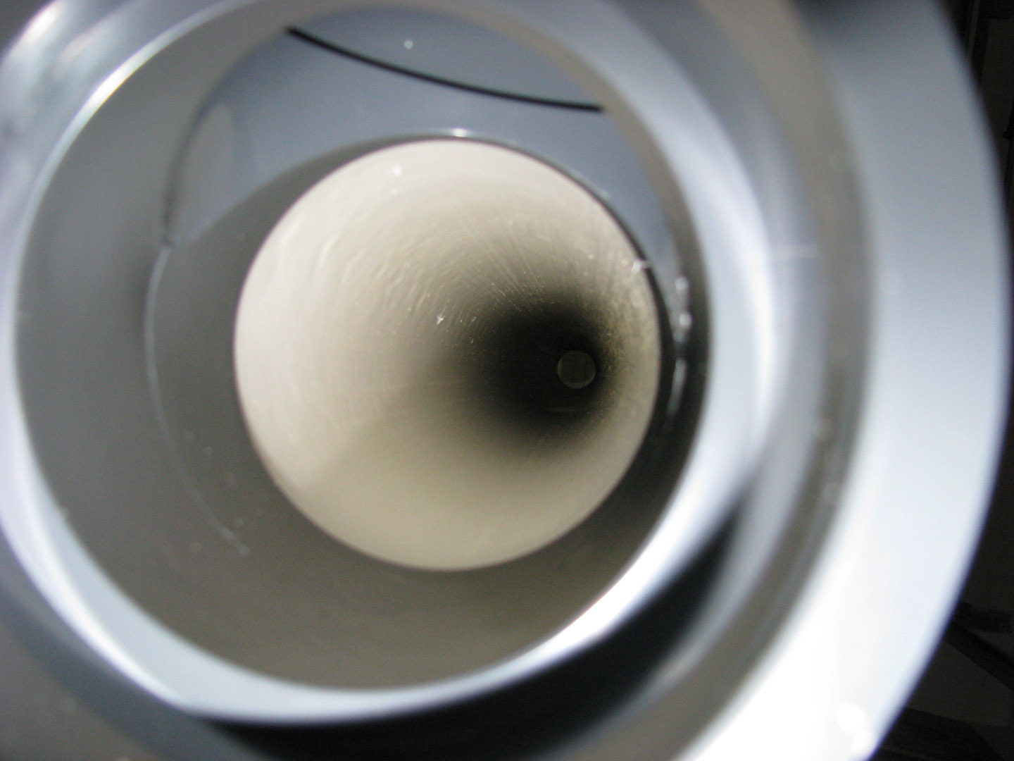

Down the barrel, from the breech.

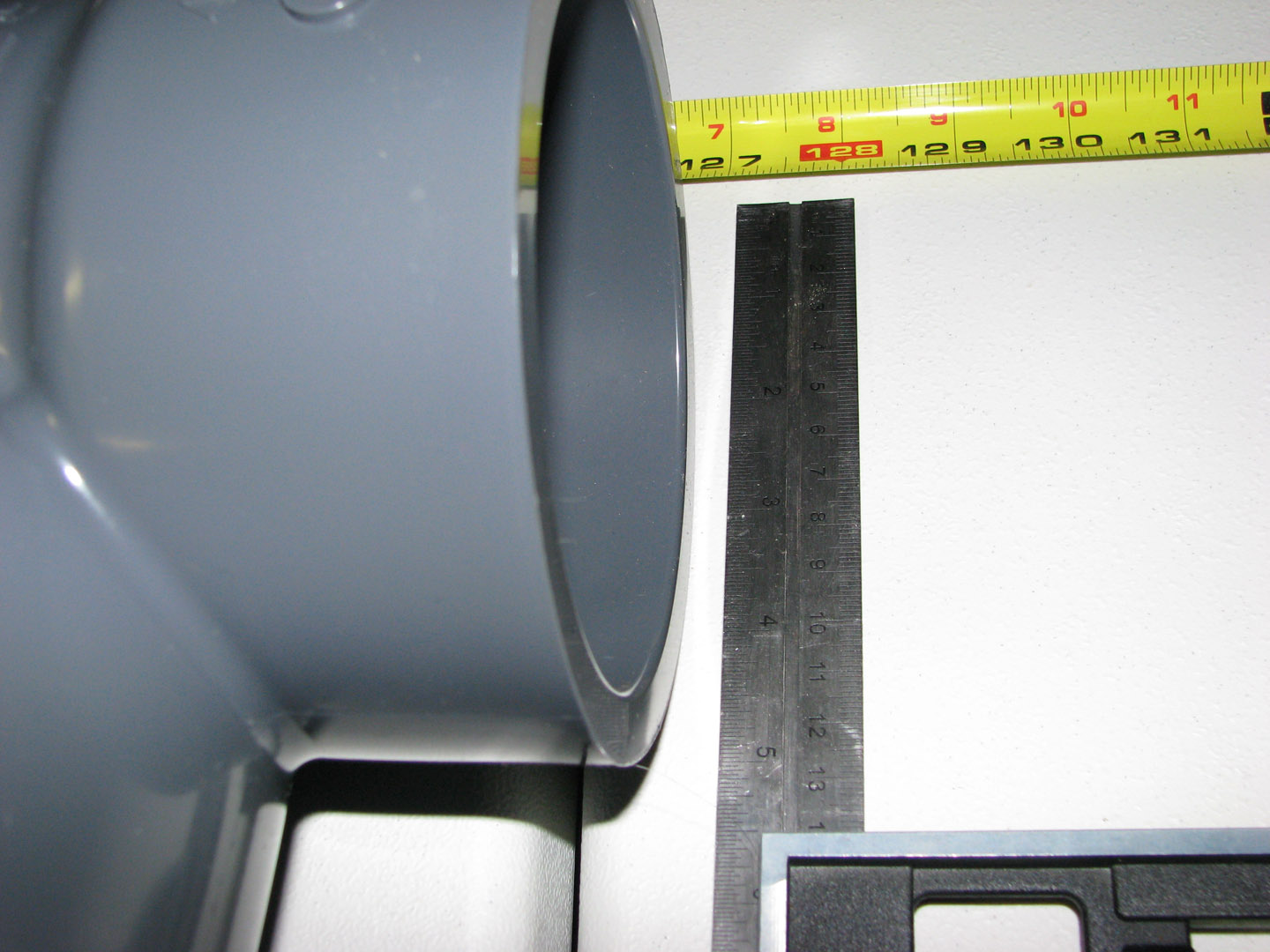

The breech end.  Over this fitting, I will be machining a vertical sliding-wedge breechblock and housing.  This will probably be the most time-consuming (and rewarding) section.

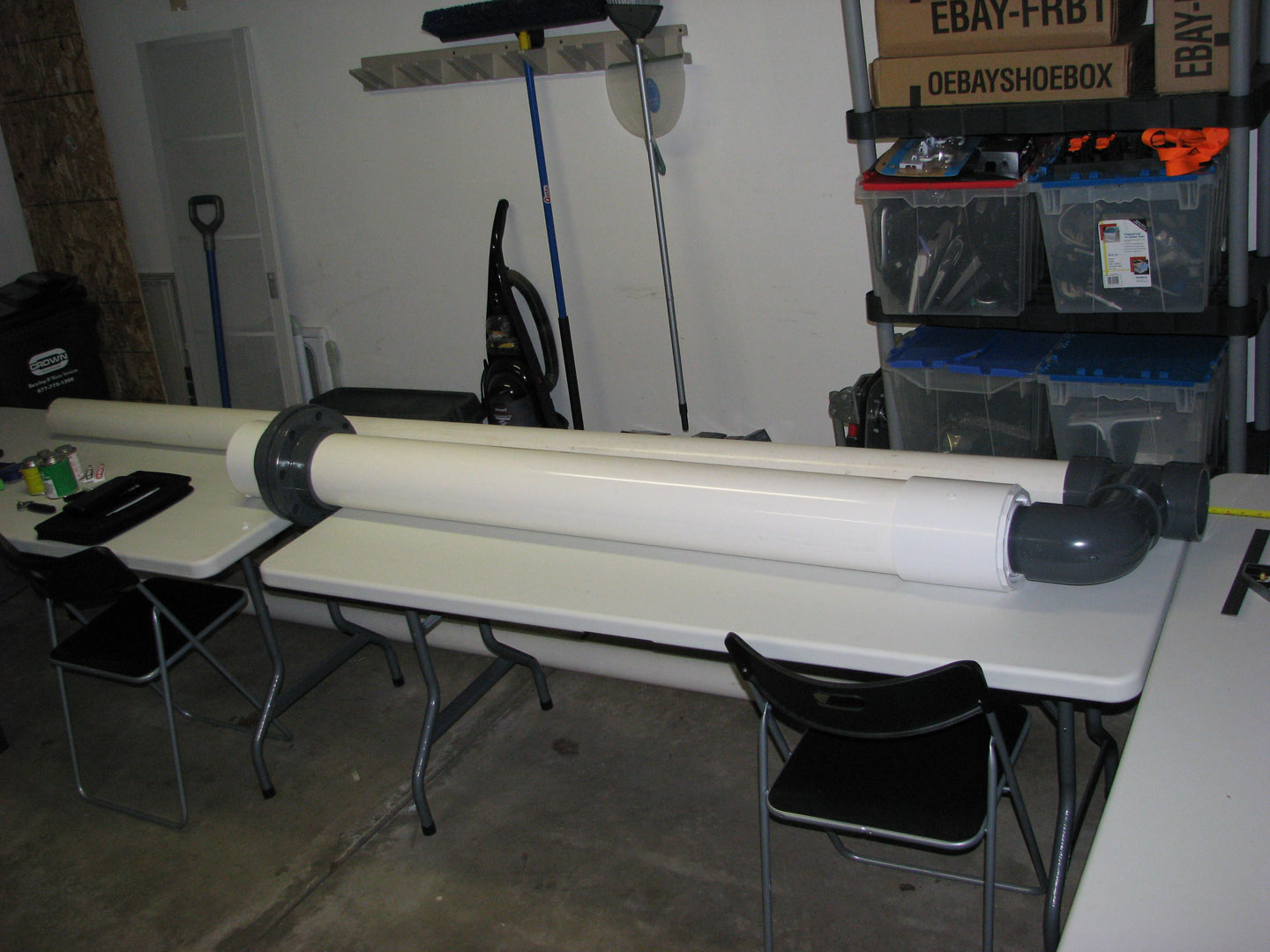

The cannon in all its glory.  Showed to give you a basic view of its configuration.
