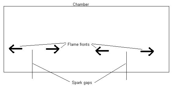

What starman means is this:

hubb017 wrote:What starman means is this:
Thanks Hubb! Here's a 3 gap solution that puts the flame fronts only 2" away from each other or the chamber wall in a 4" pipe. See it as 3 - 4" diameter simultaneous burn zones....very fast complete chamber burn...no chance for DDT...noticable gun performance.
Hey man, thanks for responding!!
Iv seen your setup around, and multi ign is def the go in my mind. Honestly though, your setup looks slick, but i cant see the advantage with just using normal sharpened screw, protruding from the inside wall of the chamber. Screws is what i will use, as the are easier to service.

Ballistica7 wrote: Honestly though, your setup looks slick, but i cant see the advantage with just using normal sharpened screw, protruding from the inside wall of the chamber. Screws is what i will use, as the are easier to service.
Screws can be more difficult than you think to line up...drilling the holes in the right position/angle is crucial...and getting the screw lengths to work out right is difficult. Also, you want to drill as few holes in your chamber as possible. So, if you are going for a multi-gap system, a spark strip of some sort makes more sense. You also want to avoid drilling holes in only one layer of your PVC chamber, thus making a center chamber gap typically more difficult to obtain with screws.
The strip I show there has only dremel cutting disk width gaps so you could easily support several more gaps cut in there with stun gun ignition. Also, you can choose to place the gaps wherever you want on the strip...just cut em in. And finally, it is easily serviced and replacable if needed.

jimmy101 wrote:The flame front is not going to migrate behind the strip very well, it'll be slow and a lot of heat will be lost. Chances are the spud is long gone before that volume gets burned. The area behind the strip will also mix slowly, even with a chamber fan.
At least in the case of my strip, it being mounted in the center of the chamber, the open gaps will allow the flame front to travel equally well under the strip as it will on top of the strip. It may not be apparent from the picture but the gaps are sawn completely through the PVC opening the bottom of the strip to the gap space. The loss of chamber cubic inches is really miniscule ( <2 ci).
Latke's strip, especially mounted on the chamber edge, does have some less that optimal design problems....some of which I have tried to mitigate with my design.
