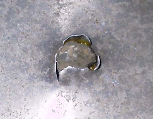

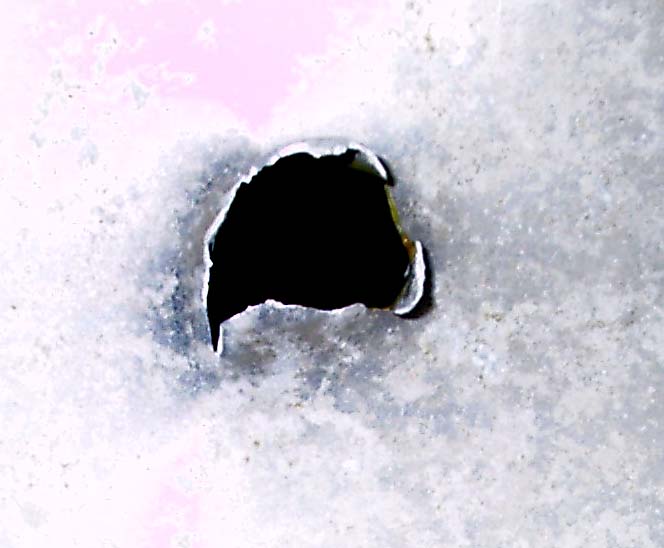

The barrel and chamber are both 1m long, the barrel is 25mm diameter and the chamber is 40mm diameter. The valve is a modified sprinkler valve. Unfortunately the particular devise that i purchased has a guide rod so I had to drill off to the side which caused quite a problem when it came to sealing the cannon. Because the barrel is slightly too big for a paintball it also allows for some more inventive ammo choices. Hows the penetration of rocks (no wadding) through this 3mm aluminium?

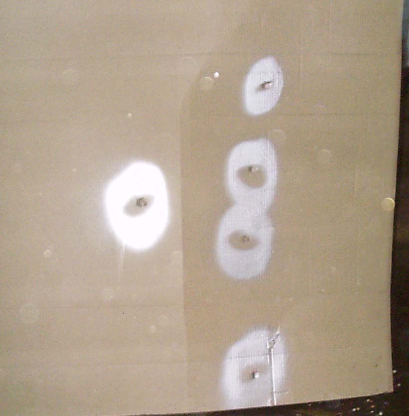

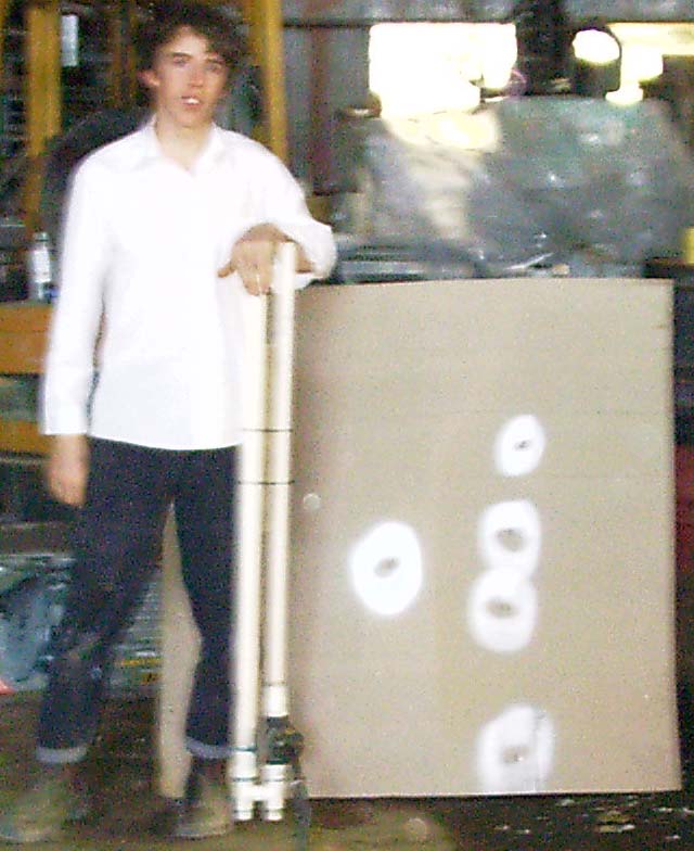

I decided to test the accuracy by setting up a cradle 20m away from a large piece of cardboard. The chamber was filled to approximately 80psi and fired. The problem is that the valve had quite a severe leak during the testing so the air pressure was no always the same. The picture shows a line of four shots, between 60cm of each other as well as a single shot 30cm off to the left. My guess is the differences can be accounted for by slight differences in pressure and paintball shape (I use second-hand paintballs from a skirmish joint next door to us) as well as a shot where the gun was not properly in its cradle.

You may have noticed that the cannon does not have a butt however it uses t-pieces instead of 90 degree elbows. This is because it will get a mini-butt later.
