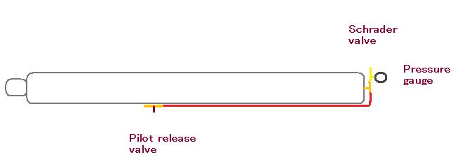

Now talking about having minimal space behind the piston, what about having space that the piston can't travel? I'd like to run some pressure hose from the T at the back of the tank, to my valve, about halfway down the gun, will the cubic volume of air be a problem if I do that?
Also, can I use a schrader valve only, on the filler side, or will I end up setting off the gun when I pull of the filler nozzle and the little puff of air that normally escapes does?

Benster wrote:Now talking about having minimal space behind the piston, what about having space that the piston can't travel? I'd like to run some pressure hose from the T at the back of the tank, to my valve, about halfway down the gun, will the cubic volume of air be a problem if I do that?
Depends on how large it is, and your pilot volume. In a fair sized gun, probably not. You could always add a ballvalve as a safety measure. Consider that a schrader valve is a poor pilot at such scales.

Here is a rough diagram of my plan.
inonickname
Posts: 2606
That will work fine. The schrader shouldn't trigger it. The shorter the length of hose is before the pilot valve, the better. Also, blowguns work better than ballvalves in this context.
