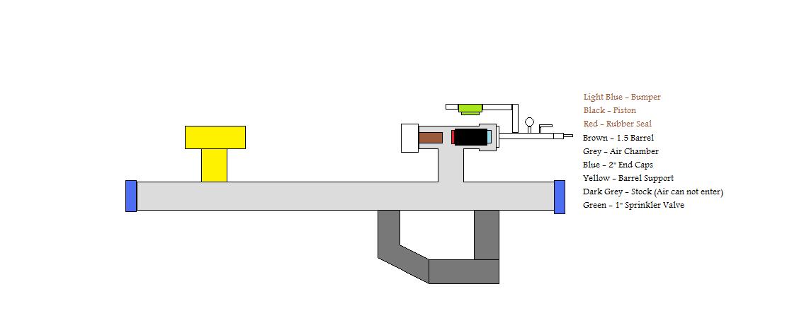

Here is quick layout of the gun that I am talking about. It is a rough draft but I think it will explain what I am talking about.
- 2in Piston Cannon
- 2inch Piston Gun.jpg (25.55 KiB) Viewed 4342 times

Why are you using a sprinkler valve?

Because the ball valves are a not as easy to use. I was also told that I would have better performance with a sprinkler valve.
If this is not correct please let me know. I am new to this hobby so any constructive criticism is welcome.
- SpudsMcGee
- Posts: 160
- Joined: Mon Nov 10, 2008 10:03 pm
Yes, sprinklers do give you better performance, but with piston guns all you need is a blowgun.

Maybe a blowgun attached to a sprinkler valve, you are losing major performance by only using just a blowgun. Unless his pilot is air tight to his chamber then he will need more than just a blowgun. :/SpudsMcGee wrote:Yes, sprinklers do give you better performance, but with piston guns all you need is a blowgun.

Really?
A lot of the piston guns I have seen on the forum still use sprinkler valves.
I would rather use a blow gun since it would save about 15 bucks and cut down on the over all bulkiness of the gun.
If you would not mind could you please explain this a little more.
Could you just put a barb fitting where my sprinkler valve is and run a tube to a mounted blow gun?
