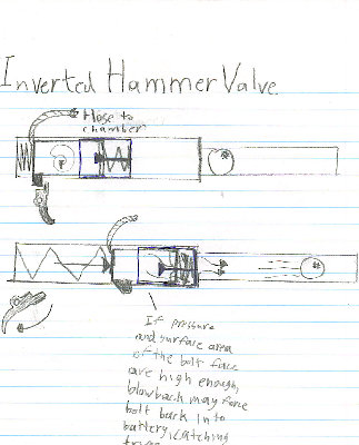

Another idea is mounting the hammer valve on the piston itself and using the static wall as the striking face for the valve. Use a large diameter hose to run air to the valve and have it seal itself off from the barrel once it moves back a bit, in essence creating a giant blowback valve/bolt. Think of a hammer valve hitting a hammer instead of a hammer hitting a valve. This should allow for huge autos.

Interesting take, could you draw a diagram?SEAKING9006 wrote:Another idea is mounting the hammer valve on the piston itself and using the static wall as the striking face for the valve.

I have a drawing in a drawer. I might scan it next chance I get.

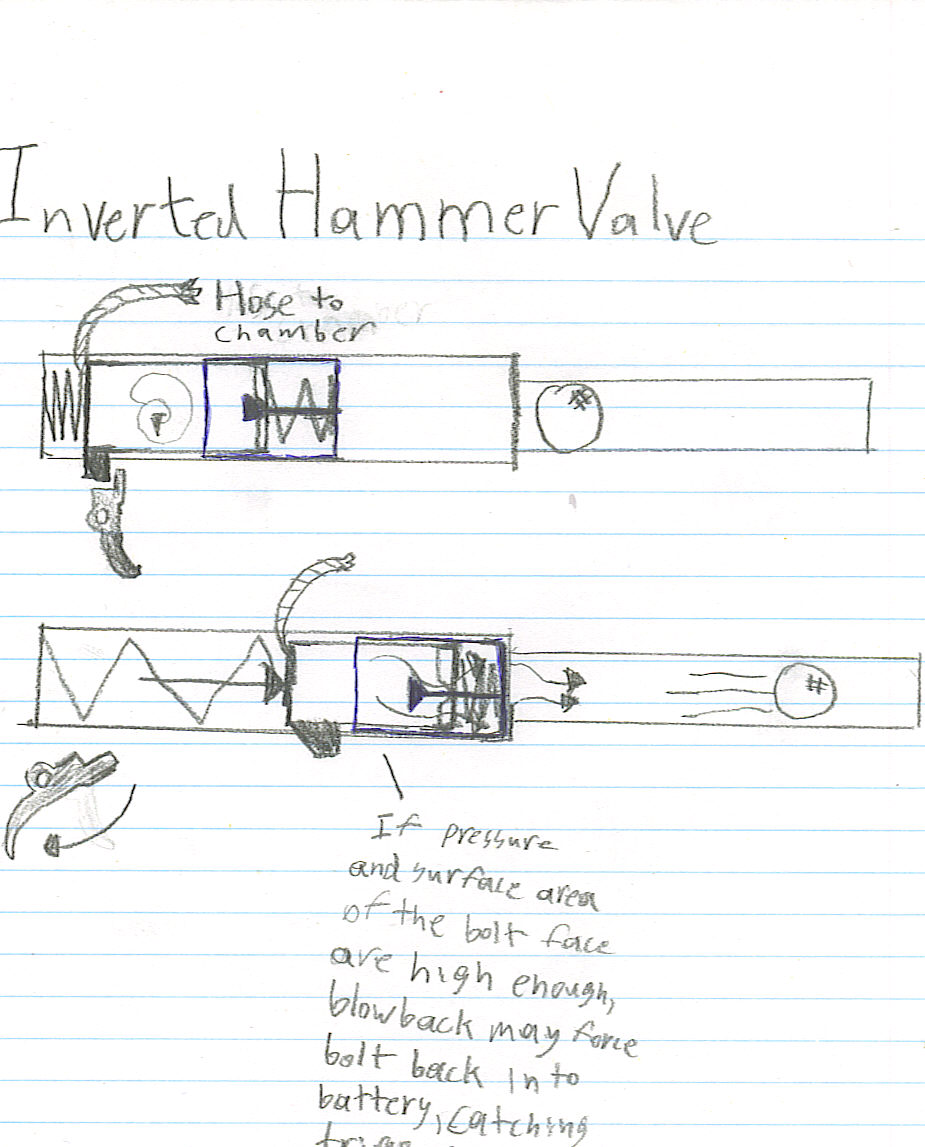

Ok, here we go. I just got all my stuff taken care of and I scanned the drawing I did a month or two ago This ones unmarked, most of my drawings have distinct markings on them.

That looks like it would be do-able, though perhaps an overcomplication when a normal hammer valve would work just as well. Still, no reason not to have a play with it
Jack a normal hammer valve will work just as well, but what would you do to open it, if you have an inline system you end up with something like the Gunpower Stealth, and no hope of semi-auto. You could have the chamber below the barrel and have a U-shaped connector between the two but then you have dead space.
I suppose the advantage to this is minimal dead space, potential semi-auto if you balance the sizes and sprin right and of course a nice breech which could load from a magazine (but he's not drawn one of those).

Oh, a breech isn't very hard. What IS hard would be to make it reliable. A uniformly beveled cartridge sliding up a ramp made from the same size pipe can be done easily. I planned on studying my M1 carbine's extractor system and attempt to replicate it. There was a video posted a while back, a 1930's-40's introduction to fireams, that demonstrated a rifle going from nary a tube, up to a giant scale 1903 Springfield. Each and every part of it, too. A variation on my reverse hammer valve could seal at the breech itself, trapping gasses between the breech and piston. This would create a form of blowback bolt. However, it would only be most useful at the medium calibers (1.5in to 3in at the extreeme end) because there are systems better suited for use at the smaller calibers that can be more easily built at that scale.
