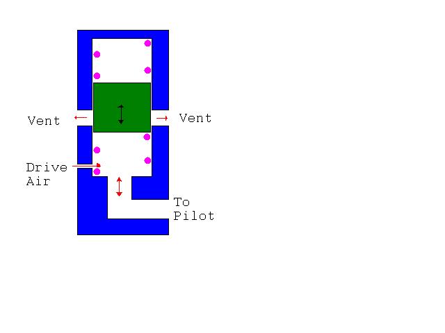

Probably not a near future project, but in looking far into the future, I have been brainstorming on a possible custom Pop Off to use with the "Gumball Machine --- Gun"jackssmirkingrevenge wrote:What I don't like about these designs is that aside from the fact that pilot volume is wasted, you still have a flow into the pilot chamber during firing. It's probably really not that much of a loss in terms of total air usage but the idea irks me.
Custom pop-offsFTW!
The common flaw with pop off valves are they are DESIGNED to open at one pressure and close at another. Often the closing pressure is very close to the pressure required to pilot a QEV, so the combinatin is hit and miss to get it to work.
The MOD
The mod would be designing a pop off not for opening and closing pressures, but as a full cycle all the way up and all the way down valve to cycle a QEV at high speed.
To do this, the 2 steps in a typical pop off would be eliminated. The spring would be longer and at a much lower tension, and instead of a flat seat, it would be a cylinder much like a piston valve. The valve core would be made heavy to make it slow.
Here is how it would work. At rest the piston would sit in the cylinder about 1/2 way to the bottom but sealed. When air is applied, the piston moves up to where the piston cork is ejected. The moving mass tends to keep it open longer than a typical pop off valve. This permits lower than normal pressure drop before the spring returns the slow massive piston.
Now that the pilot pressure has depleted way down, the spring drops the piston way down into the pilot hole and mass carries it further than the normal at rest position. As the spring rebounds and the pressure builds, the piston reverses direction and is ejected again to repeat the process.
This would make a (can't quite call it a pop off) vibrating cycle valve operate over a wider pressure range than a typical pop off. The fire rate is set by the mass spring resonant frequency, not the pilot fill speed. If the pilot volume and resonant cycle valve are tuned to each other, very high air usage efficiencies can be achieved.
Any thoughts? Will it work? Too many projects, too little time.
Maybe later I'll sketch it up with a typical cheezy quick drawing.

Sounds like a bit of a cross between JSR's rattlesnake valve, and my hammer valve/piston repeater. Definitely worth a try, but I think there would be a hell of a lot of factors to juggle to get it to cycleTechnician1002 wrote:Probably not a near future project, but in looking far into the future, I have been brainstorming on a possible custom Pop Off to use with the "Gumball Machine --- Gun"jackssmirkingrevenge wrote:What I don't like about these designs is that aside from the fact that pilot volume is wasted, you still have a flow into the pilot chamber during firing. It's probably really not that much of a loss in terms of total air usage but the idea irks me.

A diagram would be god to get a better idea of the concept

Noted. No way to scan resize and send at this computer. Will need to submit the cheezy quick sketch in the morning when near the scanner.SubsonicSpud wrote: Sounds like a bit of a cross between JSR's rattlesnake valve, and my hammer valve/piston repeater. Definitely worth a try, but I think there would be a hell of a lot of factors to juggle to get it to cycle![]()
- Technician1002
- Posts: 5189
OK cheezy Windows paint. Think it will work?SubsonicSpud wrote:Windows Paint?Technician1002 wrote:
The idea is for the piston to make the pressure to operate the QEV. It does not need to wait for the feed air to pressurise the pop-off valve. It simply vibrates saving air.
- Resonant vibrating mass QEV modulator.
- Vibration modulator.jpg (14.66 KiB) Viewed 7890 times
