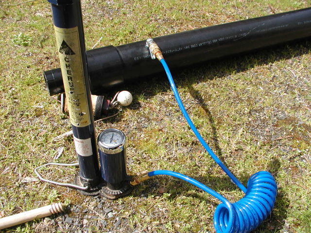

Manual- a track pump as mentioned before is best.
jackssmirkingrevenge wrote:
jmccalip wrote:What about regulated HPA? I'm not familiar with this, but isn't it gas only form?
If you're prepared to fork out for a bottle and you have filling facilities nearby, HPA is a good option.
If you do use HPA, don't forget to do the math. Some tanks are 80 cubic feet at atm pressure. Do the math to figure out just how much air you need.
For my field use, I use a high volume hand pump and prefer to shoot the small tank cannon. When we have a big bunch of guys around, they can rotate pumping while building anticipation. Gotta watch the smokers, they tend to be beat at 20-30 PSI while athletes take it on up to 80 PSI.

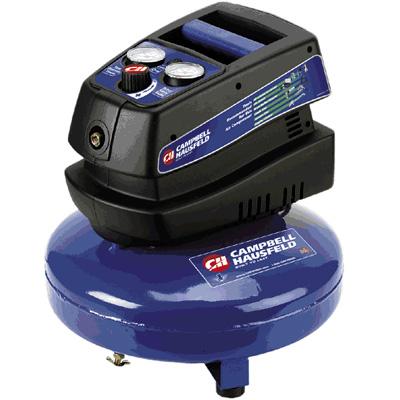

Some smaller nailer compressors will run on a larger inverter. My Prius has a 1,000 Watt inverter and will run a little compressor or a fridge compressor. Other options are a gas generator or gas compressor.
For the larger launcher I am building, something other than a hand pump will be required, so I am looking into the options.
Don't use a emergency jump kit with battery and compressor. They are OK for topping up a soft tire but worthless for repeated cannon shots.
Small compressor I am considering to run off the car inverter.

Hand pump
Hand pump
