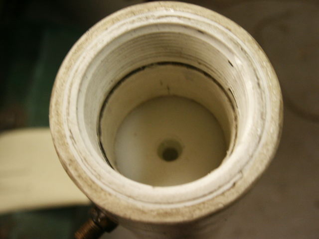

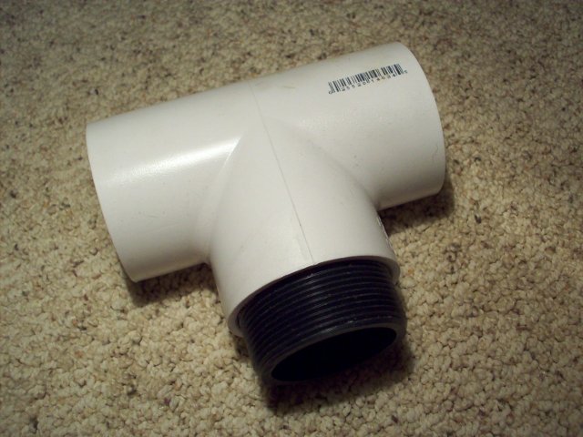

Many adapters are designed to fit the socket of a T, elbow, coupling, etc and not slip directly onto pipe. As such you will most likely end up with a 2.5 inch coupler with pipe on one end and a 2.5 to 2 inch reducer on the other with a male 2 inch adapter inside. If you are creative, you may get away with rounding the outside of the male adapter (take the flats off) and get a tight fit into the inside of the 2.5 inch pipe. It's how I made the breech of the Mouse Musket by placing a 1.5 inch female adapter inside the 2 inch pipe. I had to heat the pipe and force it on to expand it slightly and then glue it.
