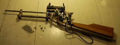

It all began with me finding a one way-valve while taking an old compressor apart. I Looked at it, and saw the possibility to make a hammer activated valve-gun!
Its quite "the wild west"-inspired, and you reload it by doing that fancy moves with the long reload-lever (please fill me in with the accurate work for it)
The lever movement both loads the striking hammer, and a new bullet in the barrel!
edit: underlever! yeeehaaaaw!
Well you see the result below.
Some quickspecs:
Ammo: steel balls; 8mm Hardened, tempered coal steel.
Airsource: One large compressor (that works)
mag capacity: 5bullets
ROF: well; how fast can you swing your arm?
spare me the comments about the short barrel; i´m not in for the accuracy anyway.

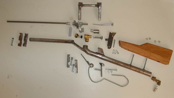

And I´ve put up a picture showing every single detail and part of the gun, it ought to be quite selfexplaining.

- stripped down
- Old Bessy Sureshot - in parts.JPG (28.71 KiB) Viewed 10227 times

I see you use the same type of one way we have over here. How did you seal the "hammer-pin" entry in the valve? I can just make out a greyish looking thing that perhaps could answer the question.
I assume the output of the valve is where there originally sit a burst disk. Really clever!
Have you considered turning the valve 90degrees, and get rid of a bit of dead space? (Connecting barrel directly)

The Gun is connected directly to a air source, therefore there is a little interest in counting the shots per fill.
concerning the valves direction, if i turn it, i have to have the hammer on the side, which is ugly looking, and also; its a bit to late to turn anything. It´s suppa-glued in place to secure a leak free construction.
when the hammer pin it hit, a o-ring is pushed against the seat of the hammer pin; making a airtight fit. The grey-ish thing is cross armed PVC-pipe.
