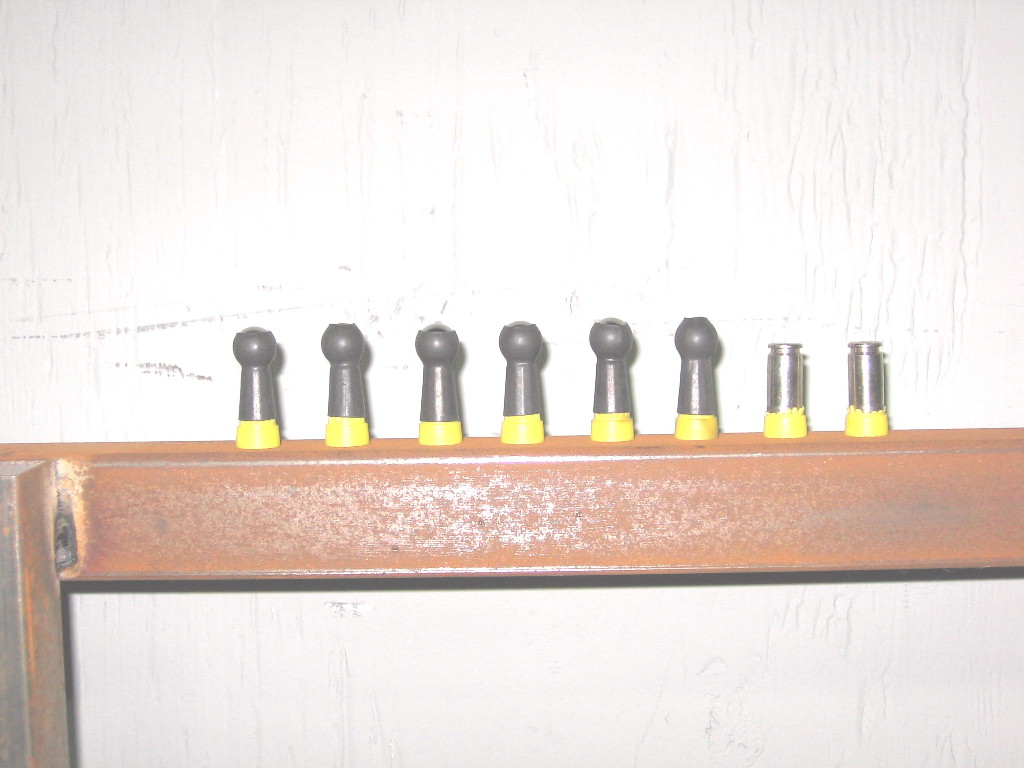

On my copper cane I found a perfect way to keep the ball from spinning...
I heatshrink yellow wirenuts to them as a tail... since 1/2" type L copper is actually.54" I use .5" balls and the heatshrink takes up about .03" they fit with very little slop, and the yellow fastenal wirenuts are right at .54" +/- .01" at the base...
I've actually noticed that these actually chrony slightly faster than 17/32"/.53125" balls I'd been using, and are way more accurate at 100yds+ than balls alone, and they have no problem poking holes in 3/4" ply at that range... the 2 rounds onthe left are my infamous .40cal casing/wirenut rounds that are great for plinking, but will penetrate a new 55gal drum at 100yds...
