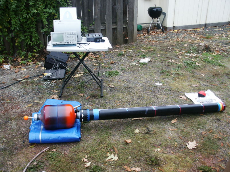

I do understand the concepts, but the math is beyond me. When you get it working, I would love to plug in some of my later cannons to see how the flow compared to a sprinkler valve of the same size.

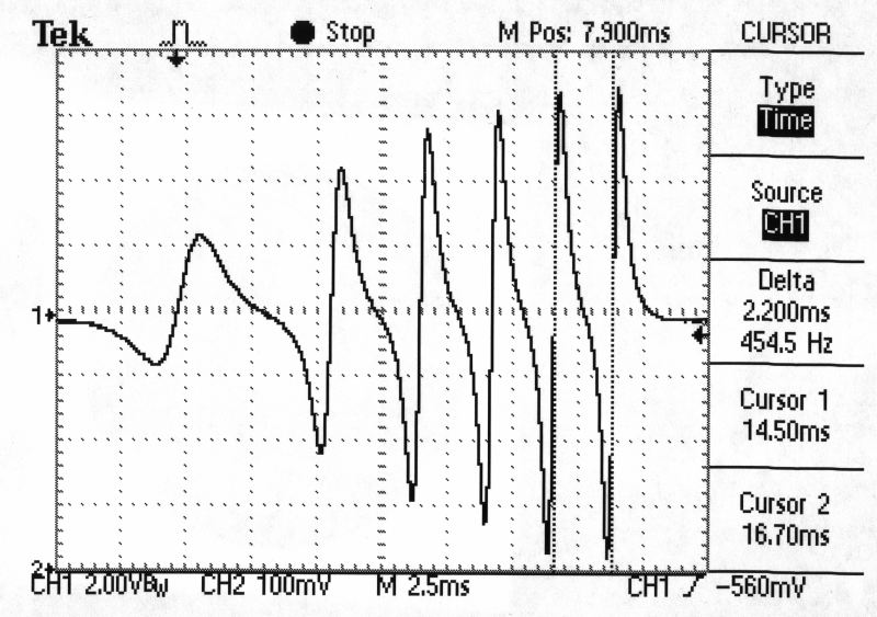

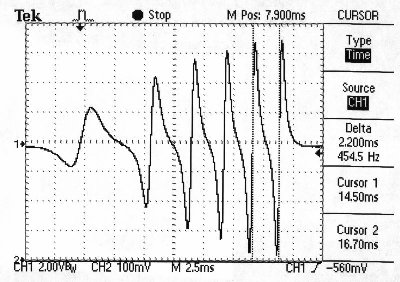

My real world in barrel accelerations have given me some insight into the assumptions GGDT makes and the low losses I am seeing. The model of the 2 inch valve with the 4 inch barrel and the light foam ball would be most interesting.

My graph is posted above if you would like to model it in GGDT. Starting from the muzzle, there are pick up coils spaced 1 foot apart along the length of the barrel. The magnet as it crosses the center of the coil transitions the polarity of the voltage from negative for entering the coil to positive for exiting the coil. The centerline crossing is the center of the coil. The first coil is not 1 foot from the projectile rest position. It is near it so it is moving as it passed the first coil. The test setup photo is below.
For those who wish to play with GGDT and the waveform in my earlier post, the 4 inch foam poof ball with the magnet installed tips my scale right at 2 oz or about 60 grams. The test shot is 60 PSI with 700 cu in of chamber volume. The barrel is 5.5 feet long. The valve is a QDV (not modeled in GGDT) with a 2 inch valve seat. The trace showing the time between the last two feet of barrel travel averages 454 FPS. I could not model this velocity in GGDT without raising the COF of the valve.
