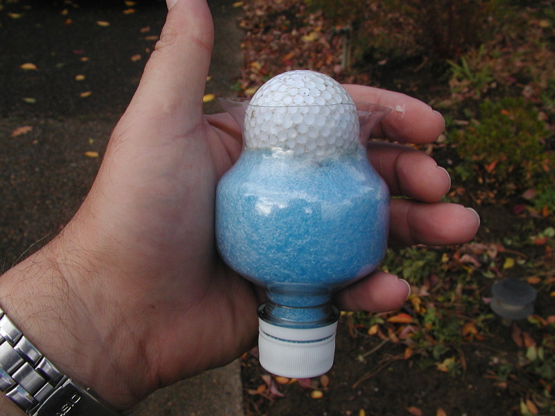

I find that at high pressure the swim noodles change size due to the compression of the gas in them. I have shot sabots past full water bottles and golf balls in the barrel. I only use the foam sabots for low pressure shots such as launching fragile eggs. Done properly is it possible to launch an egg over 100 yards.
To use a swim noodle I combine it with half of a pop bottle. The noodle provides projectile cushion and the pop bottle provides the barrel seal.
I haven't had the misfortune of exploding soda cans on launch probably because I haven't launched at over 100 PSI yet. A 100 PSI soda launch provides a whale of a kick.
