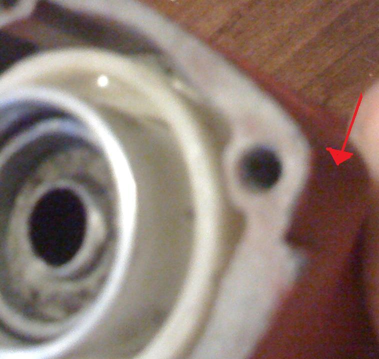

i was putting it back together and overtighten a bold and cracked the nailgun threaded part
anyone have and idea on how to fix it ?

its cracked down the side where the red is. Sorry for the crapy pic batteries are dead lol

Is it possible to run the bolt through and put a nut on the other side?

thanks psycix i think i could do that ill give it a try

You could also put some Araldite in :)

EEEEEEEEEEEEPOOOOOOOOOXYYYYYYYYYYY
fixes everything. Just mix some up and pour over the crack. Try not to spill it through the hole, and just rub it into the crack and wipe of the excess. I'm honestly not 100% sure well that would work but its the first thing I would try :roll:

Yeah what he said up there, epoxy fixes everything :D
May the gods of binary adhesives smile upon you :)

thanks guys i filled the crack with epoxy last night and will try retap the threads thru the epoxy

if epoxy don't work can i fill the hole with melted solder and tap that
The part that cracked, whats it made of?

aluminium
