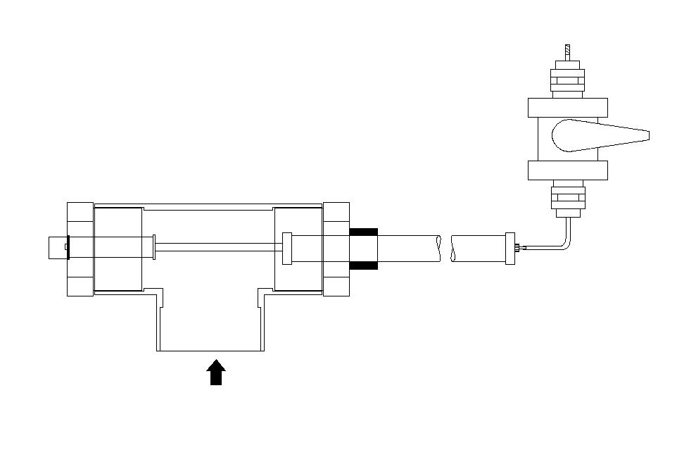

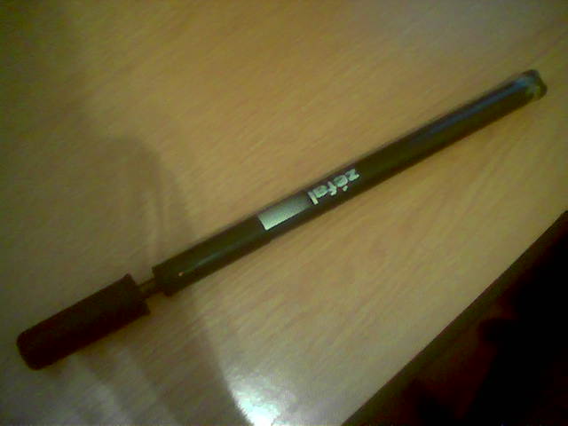

Well, I have always known how useful bike hand pumps are, they are essentially ready made pistons with a removable one way valve at the end.
I use them to fire kebab skewers, powerful shots of water and most recently as shock absorbers. I noticed that by covering the air exit port with my thumb (after removing the one way valve) I could compress the air inside without any leaks. I used this idea to make adjustable air shocks, but my next use for them is going to be the following design for a simple piston valve.

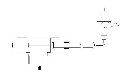

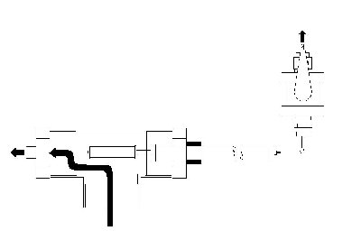

Pump air into hand pump through schrader (valvless), close ball valve, plastic washer seals barrel, pump chamber, air trapped, open ball valve, seal releases (another part of the piston is not shown, the part that seals inside the tee or a spring can be used), air escapes through barrel
I am not going to go into too much detail, I think the pictures explain a lot, but do not hesitate to ask about anything in particular.
Also any suggestions will be useful when I decide to finally build it so speak up!
Easy to make piston valve, hopefully!!

Did you use 1 of them scetch toys with the 2 white nobs at the bottem to do your drawlings? If so-dam good job! It seems to have a lot of parts to it, wouldn't building a simple piston valve with a tee/end cap/1/4" bolt and rubber washer for a seal be easier?
Heh, no, I used MS-paint ( I know its laughable seeing as I study engineering drawing..). I was planning to take advantage of the fact that those handpumps are quite effective air pistons.
Plus I believe that this saves time, since the piston is ready made.
If needed the piston the sealing end of the handpump can push a larger sealing face for larger bore cannons. This design has many problems but it shows the basic idea.

It depend how much you pump up the handpump. When I had made my shocks. I put a fair bit of my bodyweight onto them and still about 2 inches of handle stuck out, the gauge showed that it was at about 80PSI , now I don't really know if this is safe since the walls of these things are not made out of pressure rated PVC.
I've seen high-end pumps with gauges that go up to 120 PSI, but they were 40 to 50 USD.

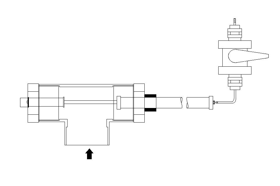

yes it will if you make it like this
Parts List: (The numbers in the diagram correspond to the list; all parts are SCH 40 PVC)
01] 2" 90 degree elbow modified [the piston face of the elbow was cut off 0-1/2" to fit through 4" "Tee" opening during assembly]
02] 2" pipe cut to 4-7/8" in length
03] 4" x 2" bushing modified: [interior flange was removed to allow 2" pipe to slide through bushing]
04] 4" "Tee"
05] 4" Pipe cut to 4-1/2" in length
06] Piston
