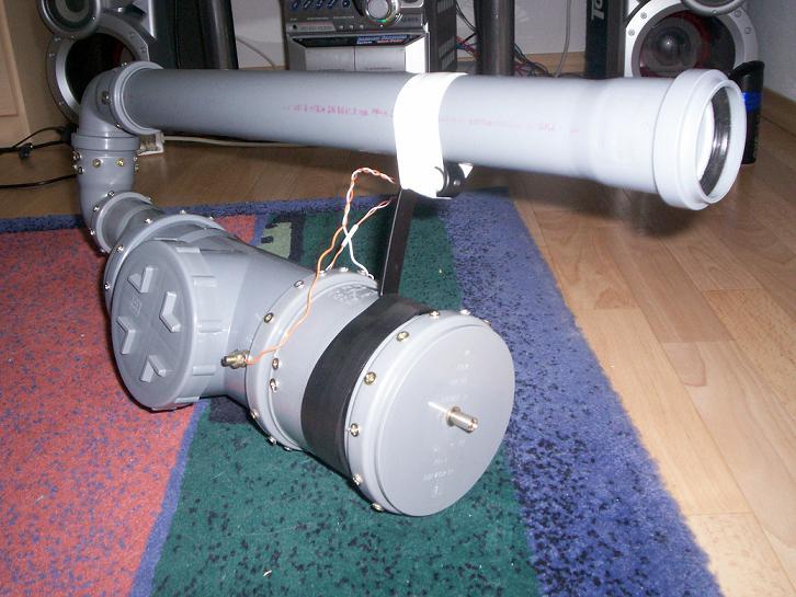

just wanna show u one of a typicle Europe P.Gun style! this is my small P.Gun.. it´s very damn LOUD! very nice sound!

could you perhaps give us some measurements, like the size and lenght of the barrel and chamber?
Maybe even some rough guesses as to the speed it shoots, and how far it goes?
Also...what's with having two schrader valves?...what kind of Valve are you using?

dude, this is a combustion, one of those "shrader valves" looks like an ignitor, because of the wires coming off of it. and the other one is prolly for venting.
i dont think so...
P.gun kinda sounds like Pnuematic
maybe im wrong though?

i wonder if the o ring at the end of the barrel works as a hop up?

hi, sorry i mean as P.Gun as PotetoGun!
It uses a simple BBQ ignition, direct propane! or manuell with "Axe Deo"
T-fitting (access panel is thereby),Diameter 100mm DN100 PA-I 2256 (70mm long burn room)
connecting piece,Diameter 100mm HTU DN100
endplate,Diameter 100mm HTM DN100
reducer, Diameter 100x50mm HTR DN100x50
pipe, Diameter 50 mm HT? DN50x800
it was not expensive maybe 15$ for plastic, 7$ BBQ ignition...
shoot = 150 - 180 meters!
