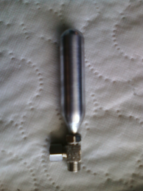

Ok, so i am building a 6mm pneumatic that runs on Duster gas(with an airsoft duster gas adapter). I had a broken airsoft gas pistol that ran on duster, so i stripped it of its parts and used the fill valve. I also found a T fitting(3/8 inch) that is male on all 3 sides. i then took a 12 gram empty co2 cartridge, drilled out the nozzle, and flared it then attached it to the T. I then took the fill valve and put it inside another one of the openings on the t, put an o ring on it, then screwed a female fitting over it to secure it. I plan on adding a 3/8 inch mini ball valve, and a quite long barrel. This will only be a single shot rifle. it will be a U shaped cannon(cant remember the word). It has been a year or two since i built a cannon, so bare with me. Thw whole thing is VERY compact, it will be about 1 foot in legnth. And i am not going to use a stock like i did in the pic.

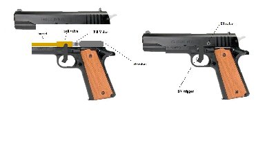

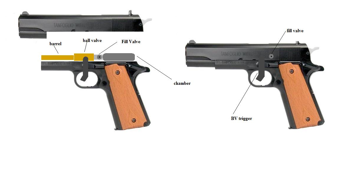

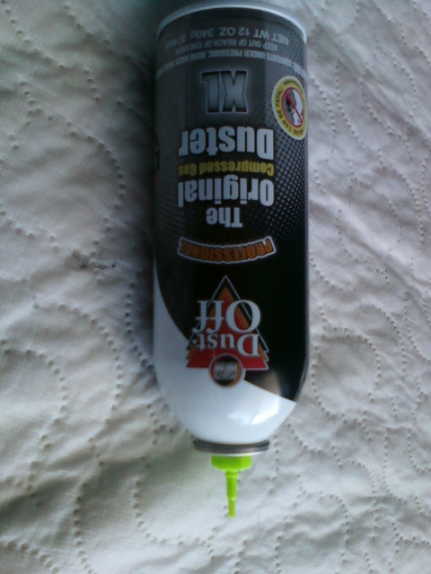

I have totally changed the design of this pistol. I decided to use parts that i already had(3/8 to 1/4 adapter, 1/4 inch ball valve, and an old airsoft barrel) and kinda rebuilt this. I have found out that when i fill it up(holding the can upside down so the liquid enters the chamber, like you do with airsoft gas guns), then open the valve the air keeps comming out the barrel for about 2-3 seconds at a fairly high pressure. I also found a nice high quality Colt 1911 frame(airsoft), and put the Gun internals in the 1911 frame to make a gas pistol. There is also a spring attached to the ball valve handle(trigger) so that when i release my finger from the trigger, the trigger returns to its original position, allowing for multiple shots. I now need to come up with some sort of magazine for it. i will take some pictures and post em up tommorrow when i have some sunlight.

If you put the internals in that case, then the BV won't be able to open very far, unless you trim the handle a bit. Sounds good.
