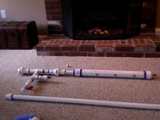

My friend and I built this cannon is it a triggerable burst disc, it uses two one inch unions and a ball valve for the valve and has a 24in by 2in chamber. The barrel is 1in pvc about 50in long and the whole gun is 8' 3" long. I assembled the piolit valve so that there is a 1/2in endcap after the 1/2in valve with a hole in it so that all of the air doesn't rush out of the piolit after the first disc breaks and this still does happen with low pressure. At 35 psi I can't even see the ball go out of the barrel. I am hopefully going to paint it red and name it something better that "burst disc bouncy ball cannon" my whole valve is one inch threaded on both sides so I can replace it with a 1in sprinkler valve or a ball valve which I wont ever do. Firing video soon. does anybody know any other ammo that fits in 1in pvc I will post a video of me firing it if I like the idea. Oh yeah by the way this is my first good cannon so any critisism is welcome
nice cannon but there are some improvements than can be made. first of all cant quite tell bu the coupler on the chamber appears to be DWV but only a better pic would confirm this.
also the MASSIVE dead space between the burstdisks is killing your preformace. you want that area to be as small as possible and if its small the gun will fire faster after opening the ball valve and with less wasted power.

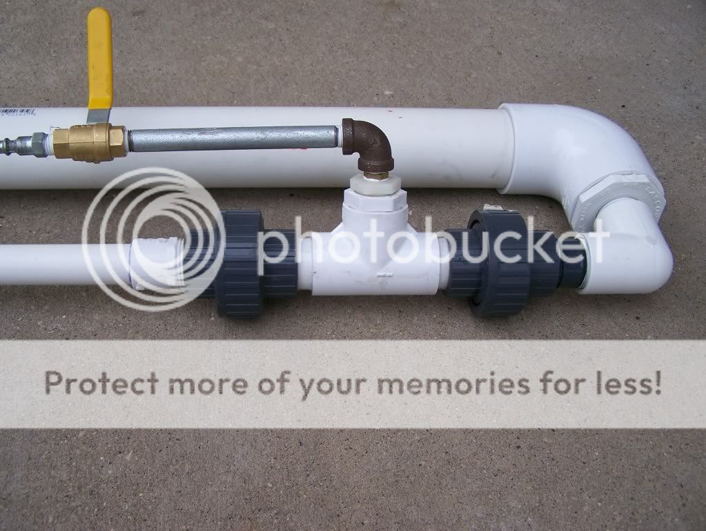

<a href="http://s696.photobucket.com/albums/vv32 ... 0_8630.jpg" target="_blank"><img src="http://i696.photobucket.com/albums/vv32 ... 0_8630.jpg" border="0" alt="Photobucket"></a>
this is a example of a a setup with less space but its even this example could be i proved
otherwise i bet you are having fun with the preformace of burstdisk

I'm keeping the pressure low until I get a better coupler on the chamber, I am aware that it is not pressure rated and am not going to take it over 50 psi until I can rebuild the chamber. I will try to rebuild the valve adventually if I can get a threaded schrader.
