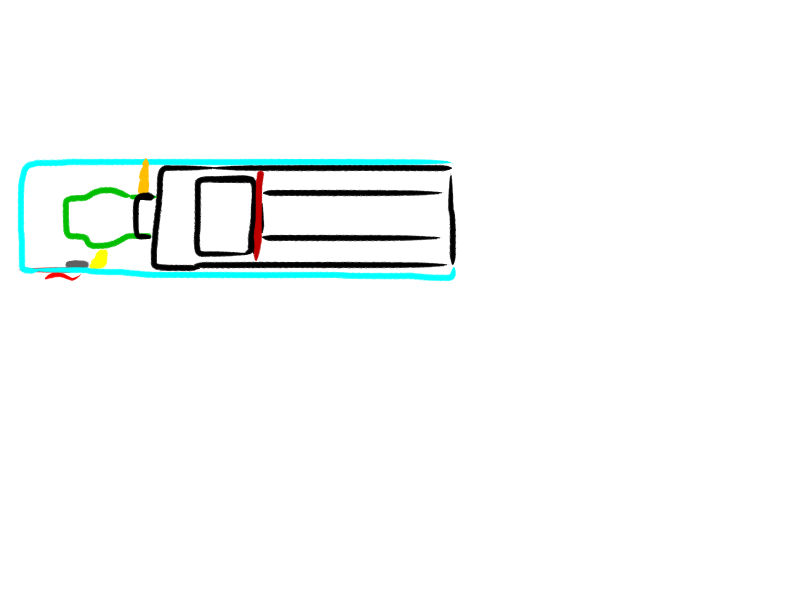

So I have some 2" and 3" scrap pvc laying around. I realized that my paintball grenades fit perfectly inside 2" diameter pipe. So I just came up with a design for a m203 style grenade launcher.
My only question: Is 3" pipe going to be a large enough chamber for a 2" barrel considering it's coaxial? I'm only hoping to get about 100' or so of range. Should I bumb up to a 4" chamber?
This is going to be my first piston coax, so any tips are welcome.
EDIT: pressures of around 100 psi, and the grenades tend to weigh 2 lbs.
Coaxial Paintball Grenade Launcher
- Diagram:
Light Blue: m203 style casing
Black: PVC
Orange: Shrader Valve
Green: Sprinkler Valve
Yellow: 90 degree brass fitting
Gray: Blowgun
Dark Red: Sealing Face - hfdhg.jpg (27.19 KiB) Viewed 4566 times

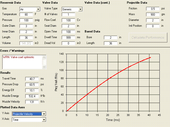

what pressures are you planning on running at, and how much does the PB grenade weigh?
- Gun Freak
- Lieutenant 5
- Posts: 4971
- Location: Florida
- Been thanked: 8 times
Plug it in to GGDT and see. Or, do some simple math and determine the CB ratio, that should help a bit if you know the pressure you want to run at (which I presume is around the 100 psi range).
With a 3" chamber and 2" barrel, C:B ratio should be around 1:1

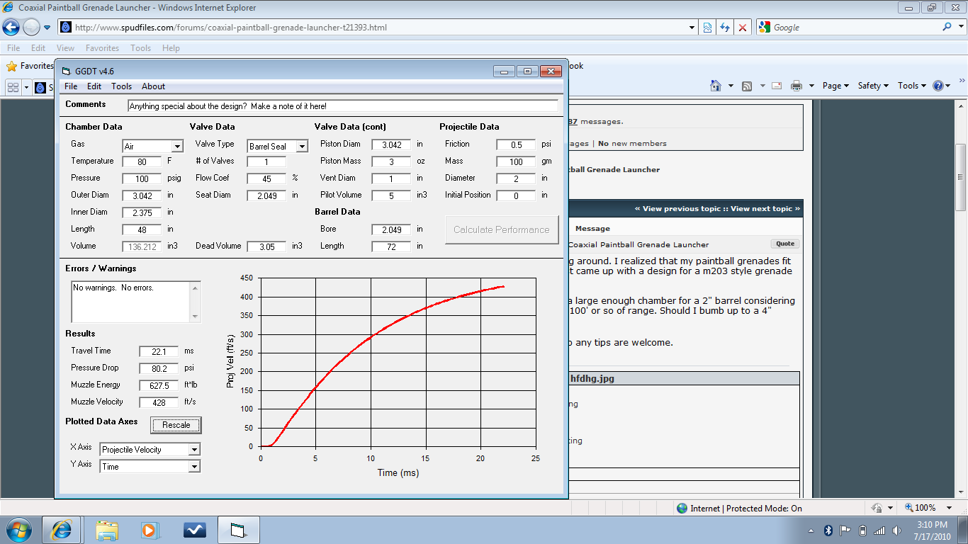

Here are the results of a rough model in GGDT, rough because you didn't provide any details of what you planned to build other than barrel chamber and valve.

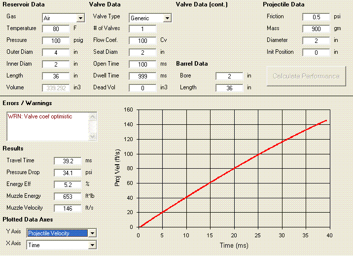

Comparing pipe fittings at Home Depot, I decided to bump up to a 4" chamber.
I plan on running at pressures of around 100 psi, and the grenade weighs about 2 pounds (purdy heavy fer spud gun ammo).
