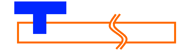

Hey guys, it has been 1 year since i made my last rifle and with school out, i got the urge once again :) :)
I am planning on using some square ally tube for the pressure chamber for a simple "inside a T barrel sealer" i have everything else figured out.. maybe..
But i have run into a bit of a snag with this pressure chamber. i can attach it to my t, but i have no idea how to seal off the ends.
any ideas??
example
example
rifle tank1.png (3.03 KiB) Viewed 3510 times

Using a square chamber isn't a very good idea. Unless it's very thick and at low pressure, you'll put far too much stress on the corners.
inonickname wrote:Using a square chamber isn't a very good idea. Unless it's very thick and at low pressure, you'll put far too much stress on the corners.
As the man says, there's a very good reason why there are no sharp cornered pressure chambers.
I made one once :roll:

yeah i though about this heaps, but i need a flat surface to thread T's and other thingo's into.
I would like to go ahead anyways as i'm planning on running this at <100psi~
I have filed a little notch into one of the corners so i know exactly where it will blow when it does.

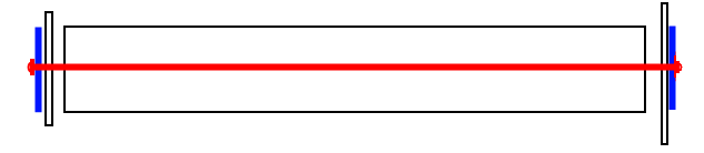

This is going to be a small cal 10mm od target rifle primarily, but i am making it so that i can unscrew the barrel, trigger valves and chamber to change/replace things. I may even use it at 50psi for nerf. idk yet.
yeah i remember seeing that before jack... thats the nasty side of this hobby i guess. :(
tank 2.png (2.08 KiB) Viewed 3493 times
Just to have an idea of the forces involved, imagine your chamber is 1 inch square and 12 inches long.
At just 50 psi, there is a force of 600lbs/272kg on each of the 4 sides trying to rip the thing apart. I would urge you very strongly to reconsider using this material as a chamber, unless it's exceptionally thick walled and very small cross section.

you could always hide a round pipe inside of a square body. Get the fit rite (telescoping) and you can just tap straight thru both of them and keep your flush square corners. Much better idea than pressurizing square tube.

Or, have an endplug machined from square Al that you can thread the tee into. I think a round chamber is more visually appealing anyway.

Well even if i do use a round tube (which i will be), i still have the same problem. what to do about the ends? :S
my current situation:
i'm still at school so im in constant lack of funds.
I own a bench grinder, vice, hammer, saw, drill and dremal, other then than no metal work tools.

use epoxy, just make sure you roughed up the pipe really good use a broken drill bit and if you can put some screws through the wall of you pipe and into the plug.
-_- wrote:use epoxy, just make sure you roughed up the pipe really good use a broken drill bit and if you can put some screws through the wall of you pipe and into the plug.
Unsurprisingly exactly what I was going to suggest.

I know we've mostly sorted this issue now, but for a demonstration of why "square is bad", take a look at the De Havilland DH106 Comet 1.
The stress concentrations around the corners of the square windows meant that two of them tore themselves apart in mid air only a couple of years after their introduction.
Square is not safe as a pressure vessel, even if you do think you're using low pressures. The stresses involved can be whole orders of magnitude greater than with a round pressure vessel.
I should mention that this relates to the internal shape of the vessel. If you were to bore out square bar stock to have an cylindrical inside, that would be perfectly safe, if carrying a lot of excess weight in the "corners" which would add no strength over a completely cylindrical vessel.
Machining a square inside into cylindrical stock... still got the problems of a square vessel.
To have end caps as strong as the pipe, I would recommend having the ends welded on with a TIG welder. Due to the material used, I recommend taking it to a metal shop to be done properly. It only takes a few minutes per end so shop charges should be reasonable. Look up Metal Fabricators in the local area.
