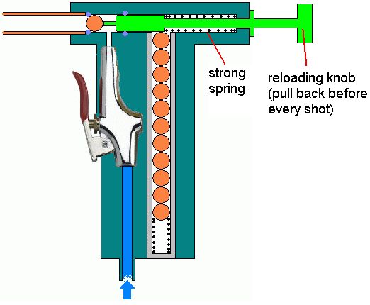

If you want to fire single shots, why not make the valveless/popoff design with a straight pull manually reloading bolt?
You could conceivably configure it with an airtight magazine placed in such a manner that if you lock the bolt back, it will give you automatic fire.
Here's what I mean for single shots:

more_eggs wrote:I was more so thinking this one
Is it any more efficient?
Given the much smaller dead volume, no doubt.
What I dont understand is, what is the difference between me running mine at 150psi from a chamber and you running yours at 150psi from a compressor? Besides of course I will have to pump it, how will it loose any power compared to a gun with the same setup running off a compressor like you did in your first testing of that design?
When you have a 25 litre compressor, you won't really notice wasted air. When you have a 0.4 litre air chamber you have to pump manually, you'll appreciate the difference.

Alrighty well thanks alot for the guidance.. Wednesday is going to be a big day for me, released from hospital and straight into building..
will go with lozz08's design first and see how I go with single shots..

oh oh, one more question.. I see lozz08 has a short clip with a silicone sort of pressure fit..
I was thinking more along the lines of a gravity fed hopper which can hold a whole lot more bb's.. does there need to be any restriction as the bb's leave the mag and enter the barrel? Or will just a straight unrestricted hole into the barrel suffice? Obviously the mag will need to be airtight also considering there will be no breech setup yeah?
more_eggs wrote:Well Im sure that will provide a bit of a sting if it were to get you on some bare flesh :P
I'm assuming though you wouldn't use lead pellets... incidentally, can you get airsoft BBs? Most Aussie members seem to have difficulty obtaining them.
Just flip the tee around, but remember, the whole hopper has to reach popping pressure before it fires, so the bigger the hopper the more air you will use per shot.
Yep
Yep
