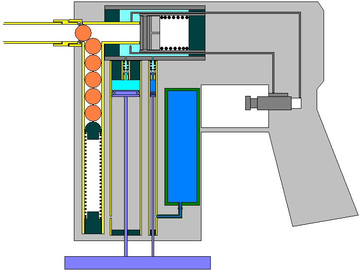

I made a diagram of how I would build a hybrid with an on-board fuel supply and integrated pump, it seems like it's feasible but the thought of getting cartridges to work reliably sounds more appealing now

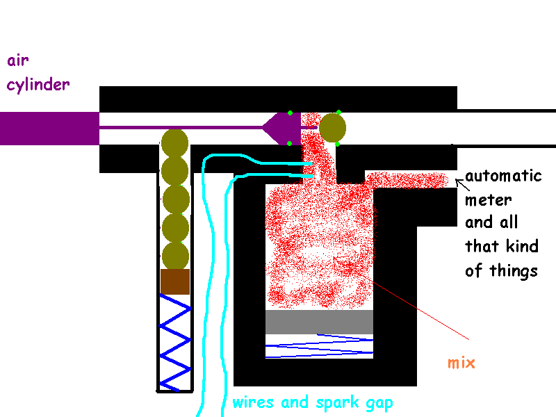

hmm... there is a detent, but why it isn't the main valve ??
ohh consider loading ammo from behind
- this should work... you might even turn it into a coaxial... ignore the air cylinder and that automated metering stuff
- automated hybrid.PNG (32.78 KiB) Viewed 12112 times
Adding the piston reduces stress on the magazine, something you avoid by adding a separate bolt.POLAND_SPUD wrote:hmm... there is a detent, but why it isn't the main valve?
My usual choicePOLAND_SPUD wrote:from behind
As I said though, I probably won't be trying to make this. Just wanted to sketch out what's needed to see if it would be practical.

Not if the gun is loadedAdding the piston reduces stress on the magazine, something you avoid by adding a separate bolt.
from behind

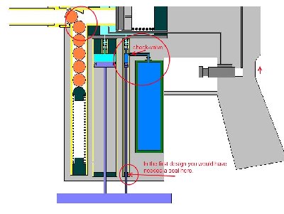

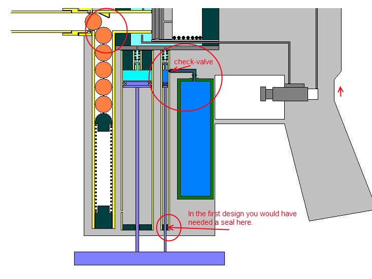

Looks tricky, but build-able, I like it, especially the double-pump-metering-system.
But I see two problems and one idea for improvement:
- Due to the fact, that one pump-piston will have a much larger surface, there will be a torsional moment at the point where the (larger-) pump-shaft meets the pump-handle. The whole construction would have to be very rigid...
-You would most probably have to add a little chute in the barrel, to avoid the balls from being pushed in the wrong direction (leading to multi-feeding...)
I would recommend furthermore, that you change the position of the fuel-line to the pump and add a check-valve , because otherwise you would have to seal the shaft of the smaller pump.
I added my thoughts to the diagram:
Edit: Don't ask me why there is a small red arrow on the right. I don't know.

I'd like to describe your solution as simply elegant.
Different piston/tube diameters for calibrated propane/air flow rates is about the best idea I've seen for repeater hybrid fueling so far. If you can get this to work it'll put the pump-action combustion I'm building to shame, even if it is about 50 times smaller.

...the funny thing is, IMO building a pump action hybrid, would be easier to build as a regular 1x combustion, because you would not have to vent the chamber between shots, what I find the most complicated part, and if you already build the metering system for a combustion, you would only have to pressurize the (rich) mix for a hybrid.

Exactly what I had in mind as a fuel sourcePOLAND_SPUD wrote:a typical lighter should be able to provide enough fuel for at least 15 shots, maybe more
I'd rather have *click-click* bang as opposed to *click-click-click-click-click-click-click-click* bangwho said you need a HPA setup ? put a pump on teh gun and check how many strokes you need to reach the ideal mix
Moar epoxyDue to the fact, that one pump-piston will have a much larger surface, there will be a torsional moment at the point where the (larger-) pump-shaft meets the pump-handle. The whole construction would have to be very rigid...
I didn't include it in the diagram but in practice a smaller diameter insert would be there to prevent backward feeding.
The problem with your solution is that the dual piston mixing relies on the fuel being at atmospheric pressure, but it's stored at higher pressure in the reservoir.I would recommend furthermore, that you change the position of the fuel-line to the pump and add a check-valve , because otherwise you would have to seal the shaft of the smaller pump.
Not as simple as I'd likeI'd like to describe your solution as simply elegant.

right, but there is nothing to block the flow of fuel to the chamber...I would recommend furthermore, that you change the position of the fuel-line to the pump and add a check-valve , because otherwise you would have to seal the shaft of the smaller pump
though if you think of it you might as well get rid of the fuel pump
