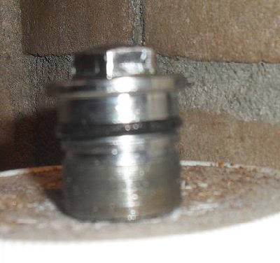

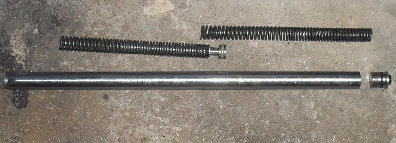

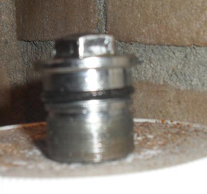

I noticed that the front fork legs from my bobber bike, that I replaced for longer ones...had some interesting parts.. :wink:
Such as a long stroke spring...a thick-walled tough steel tube and an endplug wich threads in...and seals with an O-ring.

Yep spring piston gun..
Well...I won't be able to saw off the barrel with the design I have in mind..
Because of the over under design..
Apart from the LONG stroke this twist is about the only real addition to the classic springer.
And offcourse I'll work on a diesel pump...
I'm guessing a small surface piston means higher pressure while the long stroke still provides plenty of volume.
I intend to go 9mm or so.

How are you going to make the trigger? If I look at the pictures, I see a very strong spring, wich will need some strong materials.

But wich way is the piston moving?
Mine will be travelling from the muzzle back...
This will ensure the most compact break action design.
I understand that the turn around towards the barrel isn't the best for performance...but dieseling will make up for it..
That and high flow/fairly big caliber.
The HW45 is a bit weak for my standards...
:D
I'm planning on using steel...All the way, except for the stock.
