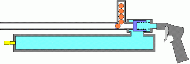

so, if you put an air regulator between the piston valve and chamber, it would not make a semi-auto gun. Regulator just lowers the pressure. Put a spring behind your piston and its semi-auto
Screw regulator and dual chambers, a spring loaded piston will do you nicely

i currently have a spring loaded piston , blow gun setup but even when i fire i cant get semi auto , it just dumps everthing in one go and ive shorten the button so i have to just tap the trigger to set it off would i have to do what wyz225 did with the blowgun mod?
- Crna Legija
- First Sergeant 2
- Posts: 2333
- Location: australia
You need to fill from the chamber and use a light hammer to open your blow gun, also you have pay close attention when making your valve. The barrel port and piston need to be very level so that it seals with the pressure of the spring alone i needed to buy a qev because i wouldn't be able to cut a straight with a drop saw. A hole for air to equalize from chamber to pilot is also required.

alright lets see , i think i will stick with my spring loaded piston valve and try to achieve semi automatic . but one question comes to mind ... what is the psi to how many shots you can get ratio? example 500 psi ,3 shot
- Crna Legija
- First Sergeant 2
- Posts: 2333
theres no ratio that i now of, more volume+more psi=more shots if you keep the valve the same.
