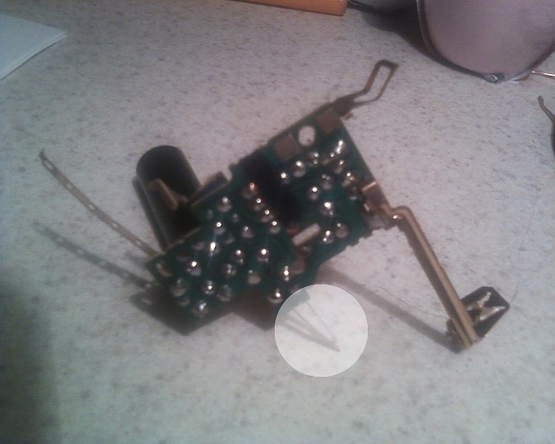

Enter the crappy cell phone pictures... No switch in sight (At the risk of sounding haughty, I probably would have identified what was described as a switch). I took a few flash pictures with the camera before dismantling, and found that it is indeed necessary to hold down the charge button until the LED begins to flash and the whine stops increasing in frequency.

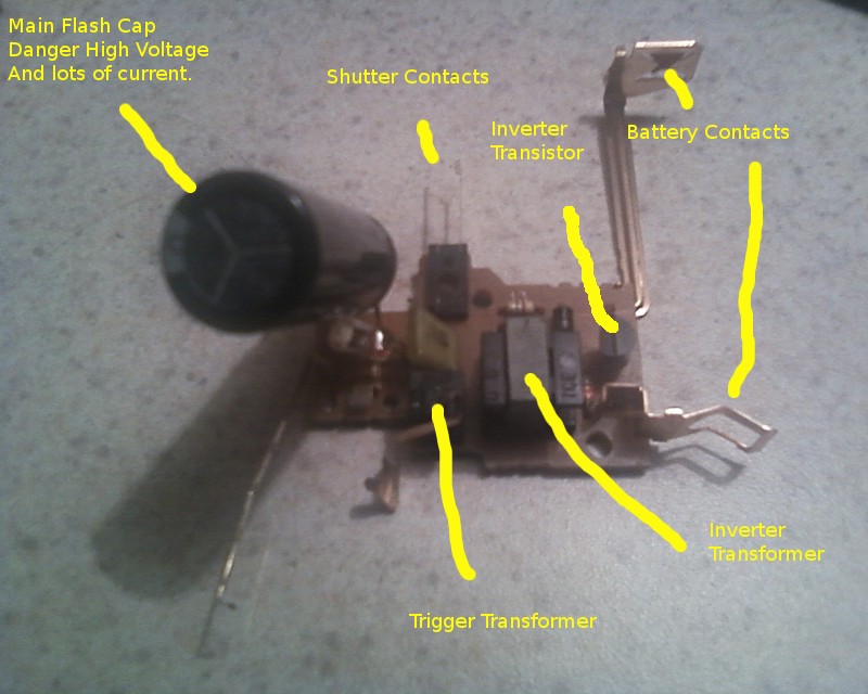

For various reasons I have a small database of flash circuit pictures and in fact the actual circuits too.
Here's the one you have.
Blue is the charging button. I can never really be bothered with it so I solder those as permanently connected and put a switch on the battery instead.
Red is the trigger switch ofc, you flip that to trigger the flash tube.
Yellow is the flash. Three connections should be there. One for each end of the bulb plus either a wire or a thin metal strip which ends on the metal reflector around the bulb. That thin wire or strip is the trigger wire.
I have no idea how you want to play with it but if you want to use the circuit as is with no further components then you need to:
Discard flash tube. Get the two connections from each end of the tube and set up two sparking points about 3mm apart.
Get the trigger wire as close as possible to this gap, I like to make a tiny loop and rig it just around the gap between the two sparking points.
Connect power to the circuit - the capacitor will automatically charge now because if you followed my advice the charging button is fixed "on".
Close the trigger switch when capacitor is fully charged.
The trigger wire will now ionise the gap between the two sparking points which will arc in a powerful spark as the capacitor discharges.
