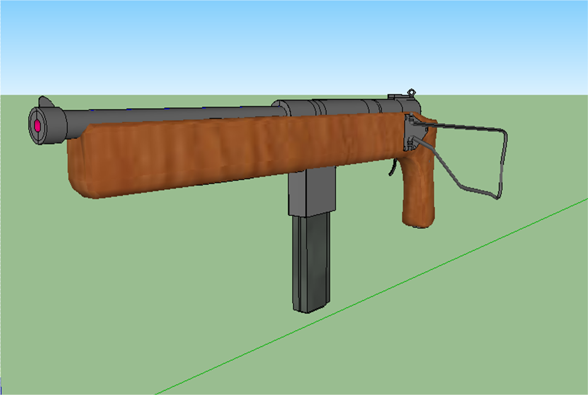

After a lot of research on paintball guns and the pop-off and blow forward designs of jsr, I have came up with the following idea, shamefully due to me being pressed for time at the moment I cannot make any snazzy animations or put pictures of the valve here but the chances are I will add them later, for now a sketchup of my entire design will have to do.
This is not just for the valve though, I have also formulated a gun (the model 55 reising) that this design will go into, the gun will be run off propane or green gas, constant flow is not a problem as my valve is quite efficient.
I have only included the bare essentials in the sketchup, that includes the valve itself, the trigger mechanism, and the location of the gas tank (the mag is worked out but due to complexity issues the details are not included in it)
I wish for some of you guys to please tell me what you think about my concept and designs I have drawn them out and are at current awaiting the purchase of building materials, please if you can see any flaws or things I might have missed please post, or if you wish to just make any comment I am all ears.
The design is pretty self explanatory but if you don't understand please ask. :D
Thank you and here is the link:
http://sketchup.google.com/3dwarehouse/ ... revstart=0
A preview of my gun-in-progress

Looks nice, i like the thin metal piece used for the stock.

looks pretty and immediately recognisable as the Reising but can't really comment on the mechanism which is the important bit ;)

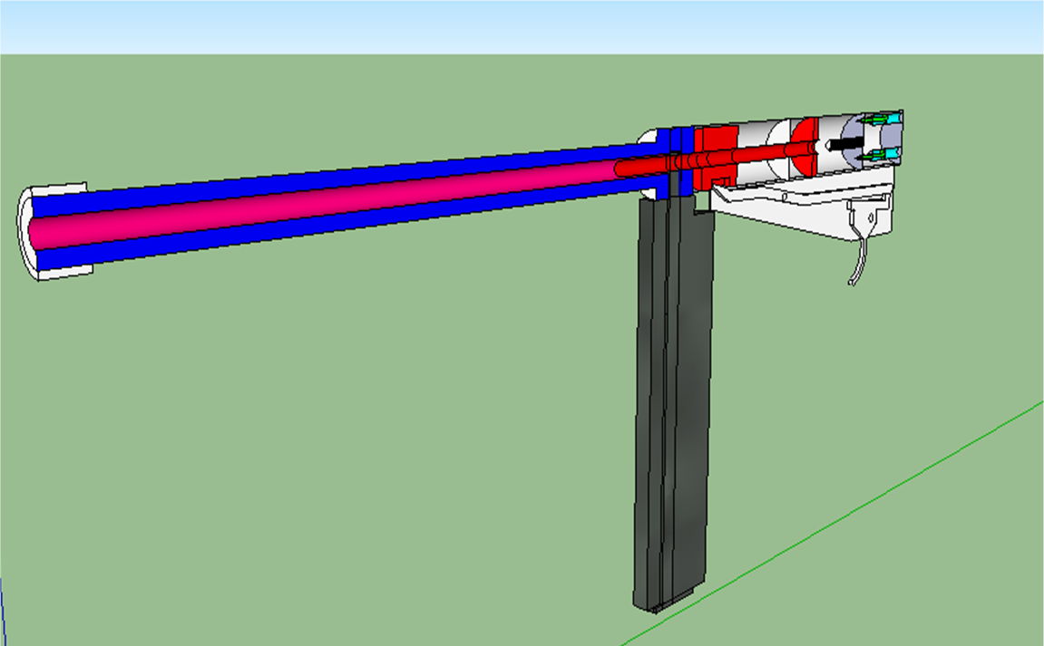

Yes jsr and Doctore are correct, the gun is pneumatic and the low liquefying point of green gas or propane means i can store more of it.
Here is the promised link to the valve system, the bits that aren't covered here are covered on jsr's many blow forward threads.
btw if you pause the animation at the very beginning the parts of the animation are labeled, due to me overlooking this when I was making it the frame whizzes by in under a second so be quick if you wish too see it!!
A animation of the entire mech is comming soon,
but these thing take time :wink:
Comment much appreciated. :D
A picture of my Interior mech (gas chamber not included)

Have you calculated the bolt spring force that will be necessary to open the valves? If the spring is strong enough to open the valves, I doubt that the gas from the valves will be sufficient to ever completely overcome the spring pressure and move the bolt to the forward position where it can re-engage the sear again.

If you can make it, I think it should work. The hammer valves should prevent it from hanging. Unless you use HPA though, I wouldn't expect great performance, maybe 400 fps for 0.20g airsoft BBs with propane, but if you want it for skirmishing that's perfect.
You're wasting a lot of air cycling the mechanism which is quite high volume, there are more efficient ways of designing it, definitely it would be worth using a single valve - 50% less things to go wrong.
why is that?, the spring will never have to directly push against the force of the hp tank, what I didn't include in the animation was the springs which are pushing the valves shut, the inertia of the spring will be enough to open the valve and keep it open as long as the air pressure hasn't reached pop-off level. once the bolt starts shooting backwards the inertia should be enough to get it too trigger latch point, if not then I will change the location of the trigger sear so it does not have to go so far. hope that has explained that. :)
Agreeably the real valve has been carefully worked out to have optimum power for the blow forward chamber, also 400 fps is what I was aiming for as I wish to use this for skirmishing.
Otherwise in my opinion the two valves would increase the performance of the gun, of course there is more to go wrong but if carefully made I think this might stand a good chance of greatly improving performance. :)
The prototype of the valve is coming as soon as I can get an empty large propane tank for an air chamber, as I have no air compressor decent enough to provide a constant stream of air. :D
I think performance will be good enough with one valve, and its worth a bit of redesign to keep things simple, plus remember you'll be reducing turbulence and gas consumption.

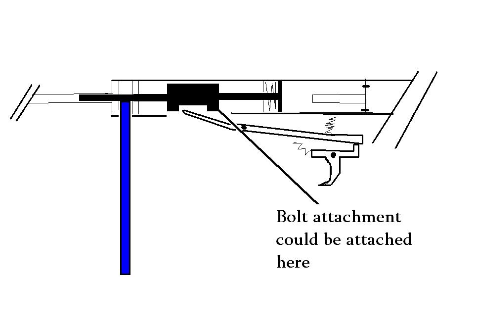

One thing you might or might not have thought about, how do you cock the bolt for the first shot or in the event of a misfire?
cammyd32
Great Britain
Posts: 326
The bolt handle can be attached like so:
sorry the picture is crude, I am working on a detailed animation of the entire guns workings :D
Crude drawing on paint showing bolt location.
Bolt location.JPG (37.15 KiB) Viewed 7127 times

Yeah, in my design the cocking bolt will be about where the shell ejection slot is, sort of emerged inside it so the aesthetics are maintained. :)
The slot will be there in my gun but there will be nothing in it apart from the hop-up adjustment screw. :D
